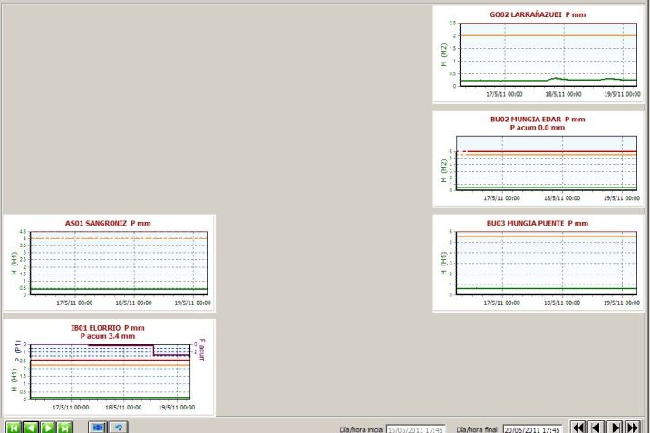

I am updating to VB .NET an old application written in VB6 which created a bunch of graphs, positioned them on screen using a customizable pattern and managed them using an index based approach (Each graph was created at runtime and assigned an index which was used for individual editing, zooming, etc...)
Since index controls have dissapeared in .NET as such I wonder which would be the best way to replicate the same behaviour
I am attaching a screen capture so that you can appreciate what I'm trying to replicate.
Thanks in advance

I'm sending you an excerpt of the code which produced the graphs in VB6

The question again is how can I define in .NET an array of charts which can be addressed through the particular index of any one chart
What I'm trying to do in VB.NET should look like this:

Thank you, Sandra, the code that you sent works, it creates graph in a tile fashion as I need.
Can you tell me how can I edit a particular graph (find its index and operate with it) using the mouse to select it?
In my case, there will be more graphs than a screen can handle, many of them will be hidden because of the left coordinate and I will only operate with one single graph in the visibility zone.
Thanks again
