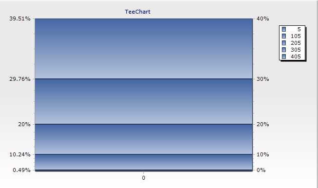

Hi Sandra,
The code you sent is working pretty well. The only problem I'm having is that my single set of stacked bars are pinned to the left of the chart space and only one or so pixels wide. Can you please tell me how to get the bars to be the full width of the chart area? i.e from the left axis to the right axis with no margin?

Re: Self-stacked bar graph with side labels?
Post by Sandra » Mon Feb 11, 2013 2:59 pm
Hello Phil,
I can not reproduce your problem using next code in last version 4.1.2012.01312:
       double TotalSum;
            tChart1.Walls.Back.Visible = false;
            tChart1.Axes.Left.Grid.Visible = false;
            Steema.TeeChart.Styles.Bar Series1 = new Steema.TeeChart.Styles.Bar(tChart1.Chart);
            TotalSum = 0;
            for (int i = 0; i < 5; i++)
                Series1.Add(i, i * 100 + 5);
                TotalSum = TotalSum + Series1.YValues[i];
            //InitializeSeries.
            Series1.MultiBar = MultiBars.SelfStack;
            Series1.BarStyle = BarStyles.RectGradient;
            Series1.VertAxis = VerticalAxis.Both;
            Series1.BarWidthPercent = 100;
            Series1.Marks.Visible = false;
            Series1.SideMargins = false;
            //Set CustomLabels:
            SetCustomLabels();
        private void SetCustomLabels()
            double NewPosition = 0;
            Steema.TeeChart.Styles.Bar bar1 = (tChart1[0] as Steema.TeeChart.Styles.Bar);
            for (int i = 0; i < bar1.Count; i++)
                NewPosition = NewPosition + bar1.YValues[i];
                tChart1.Axes.Left.Labels.Items.Add(NewPosition, (Math.Round(bar1.YValues[i] * 100 / TotalSum, 2)).ToString() + "%");
            NewPosition = 0;
                NewPosition = NewPosition + tChart1[0].YValues[i];
                tChart1.Axes.Right.Labels.Items.Add(NewPosition, (bar1.XValues[i] * 100 / 10).ToString() + "%");
The result image I have gotten is next: .
Could you tell us which version of TeeChartFor.Net are you using? If you use the last version and the problem still appears for you, please send us a simple code because, we can reproduce issue here and try to find a solution for you.
Post by Sandra » Tue Feb 12, 2013 10:16 am
Hello Phil
Thanks for information. Basically, your problem is that BarWidht property doesn't work in correct way in version 2 and it breaks your application. If you want achieve the same results than latest version TeeChartFor.Net 2012 I recommend use CustomBarWidth property as I do in next code:
 //Version 2.
      double TotalSum;
            TotalSum = 0;
            //InitializeSeries.
            Series1.CustomBarWidth = tChart1.Width;
            SetCustomLabels();
            NewPosition = 0;
        private void button3_Click(object sender, EventArgs e)
            tChart1.ShowEditor();
Could you tell us if previous code works in your end?
Lastly, is it possible to set the colour of the bars individually?
Yes, is possible. You can assign a color for each bar point. I have added a list of colors in my previous code that allow you assign one color for each bar point:
 double TotalSum;
        List<Color> colorList;
             colorList = new List<Color>(new Color[] { Color.Red, Color.Green, Color.Blue, Color.HotPink, Color.Black});
            TotalSum = 0;
                Series1.Add(i, i * 100 + 5,colorList[i]);
            //InitializeSeries.
            SetCustomLabels();
            NewPosition = 0;
I hope will helps.

Post by PhilOutram » Mon Feb 18, 2013 12:52 am
Hi Sandra,
All the things that you've suggested have worked. Job done!
Very many thanks,
