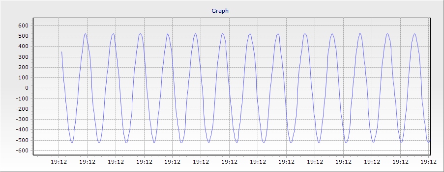

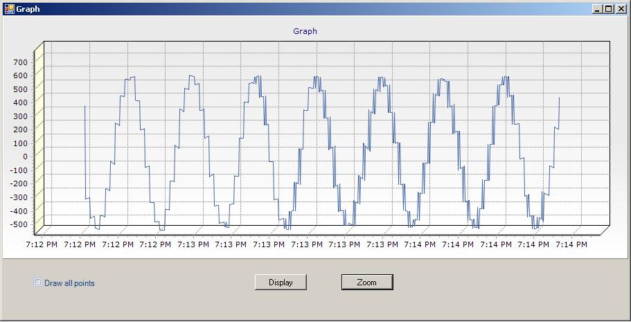

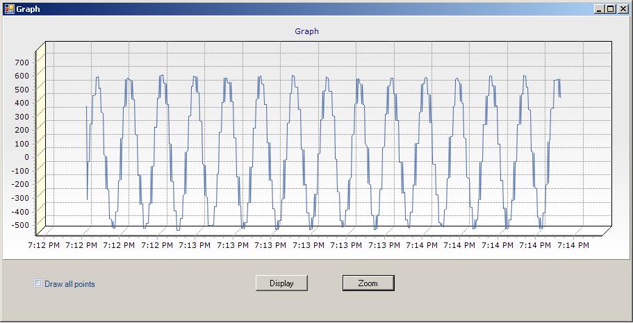

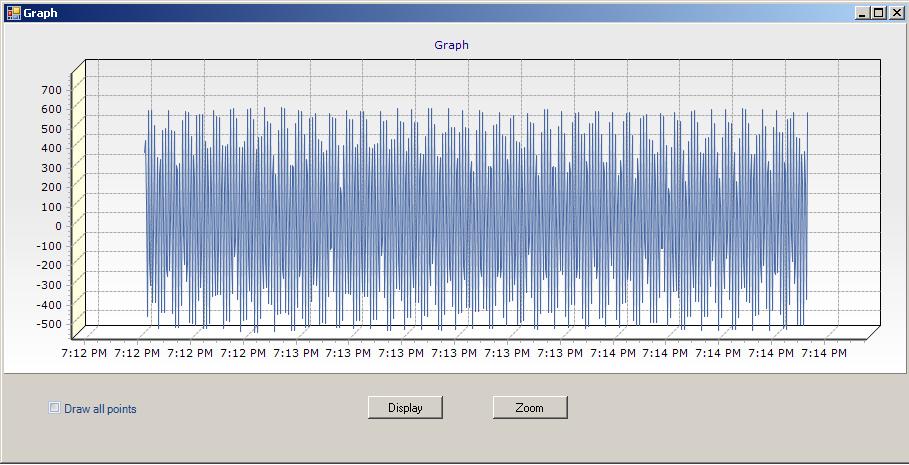

As stated and showed in my first post in this thread, the issue is that when we have DrawAllPoints=false, the graph display trend we get changes drastically with width of the chart.
For example, see the following images:
Please note that the 'Zoom' functionality simply increases the width of the graph panel and is not really a zoom in T-Chart's sense.
The initial display looks as follows:
After 4-5 clicks on the 'Zoom' button, the trend changes as follows:
After about 12 clicks on the 'Zoom' it changes as follows:
