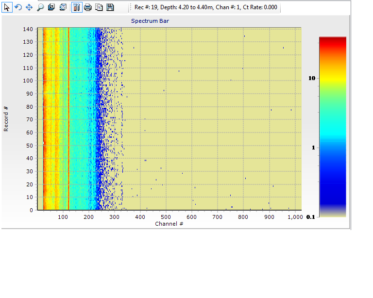

Unfortunately that example does not really help me. I will try and explain with more detail. I am drawing a color grid with the x and y axes being linear, and color representing a 3rd dimension. I have applied my own palette using the AddPalette() and ClearPalette() methods, and the color grid itself works quite well.
I want to add a legend palette to this to show the values that correspond with the different colours. By default the left and right axes on the legend palette have a linear scale. I want to change this to a logarithmic scale, so that the smaller values are emphasised.
When I look at the legend palette's properties in the designer, there is an Axes tab. If I select the Left Axis and the Scales tab inside the Axes tab, there is a Logarithmic check box. I had hoped that if I checked this box then I would get a logarithmic scale on the legend palette, however this does not seem to work. I'm not sure if it is meant to work or not, but it would be useful if it did.

I see that someone has attempted to fix this problem (ie TF02016049), however I am yet to get it to work. To turn on logarithmic scaling on the legend palette I have attempted to do it both via the editor at design time, and run time, and programmatically.
Editor at run time - I can successfully check the logarithmic checkbox of a programmatically created LegendPalette and change the scale correctly. sbar.png (attached) is an example of what I'm trying to achieve.
