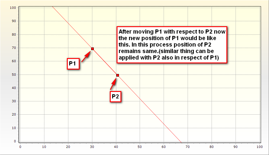

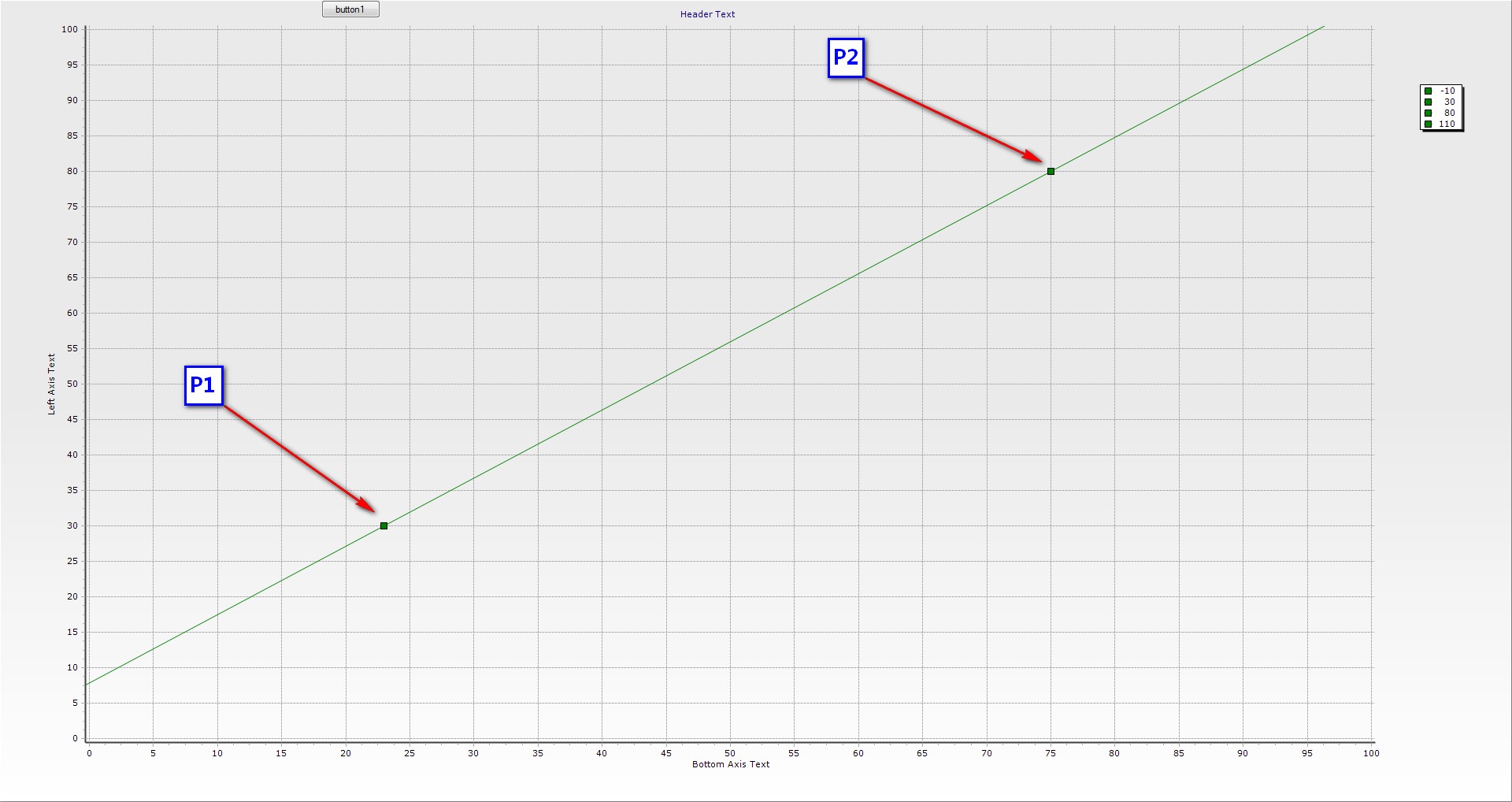

Hi Steema Support,
We are creating a line chart which have two points P1 and P2. Now we extend this line so that it touch boundaries of chart by adding two more point at first index and last index respectively. Means there is now total four points on line:
P0-> which is first point of line series and touches bottom boundary (not visible as this point is out of boundary)
P1-> which is second point of line series and always displayed on chart.
P2-> which is third point of line series and always displayed on chart.
P3-> which is last point of line series and touches top boundary. (not visible as this point is out of boundary)
However we more concerned with P1 and P2.

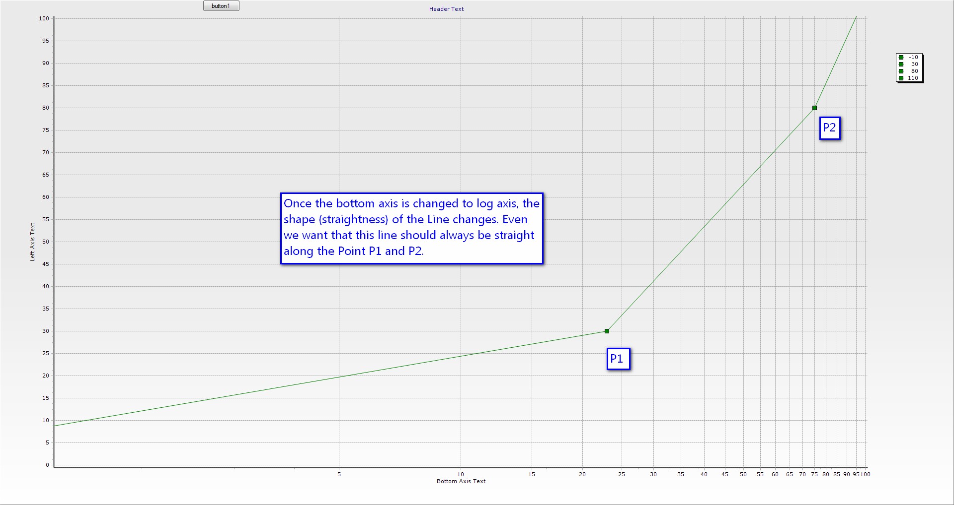

Now the problem is, once we change the bottom axis to Logarithmic axis line does not remains straight.
Our objective is the line should always be straight along with P1 and P2 point.
We are also attaching our project for more help.
Please suggest if we are doing something wrong. Any suggestion will be highly appreciated.

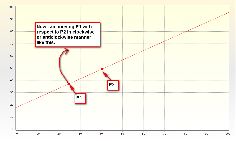

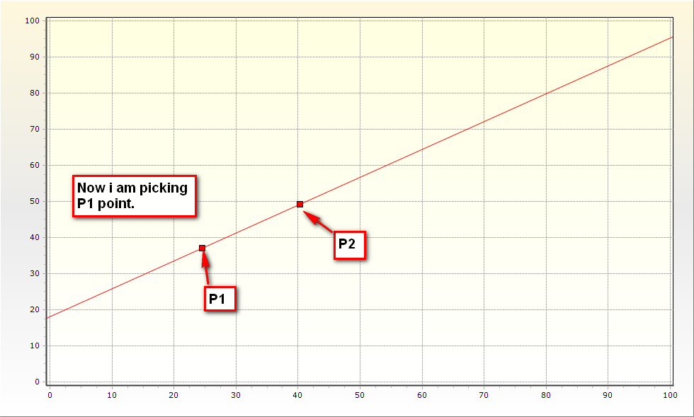

Thanks for the reply. For your convenience, now I am also attaching one video related to movement of Points of Line in Semi Log axes. I hope this will help you more to understand my problem in right way.
