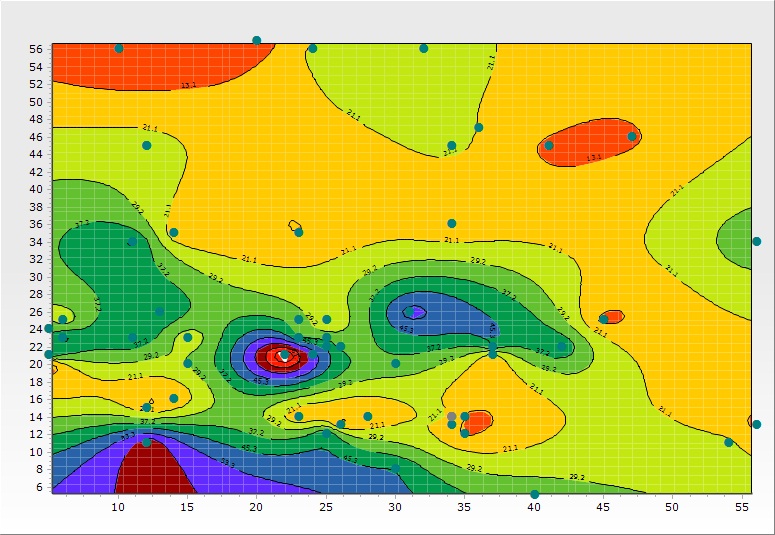

If I set smoothingmode=antialias, the contour map shows white grid lines?
Re: .asContour.Smoothing.Interpolate
Post by Narcís » Wed Sep 28, 2011 2:25 pm
Hi lilo,
This is the same you already found here. The demo example Sandra pointed you doesn't involve setting SmoothingMode to AntiAlias.
