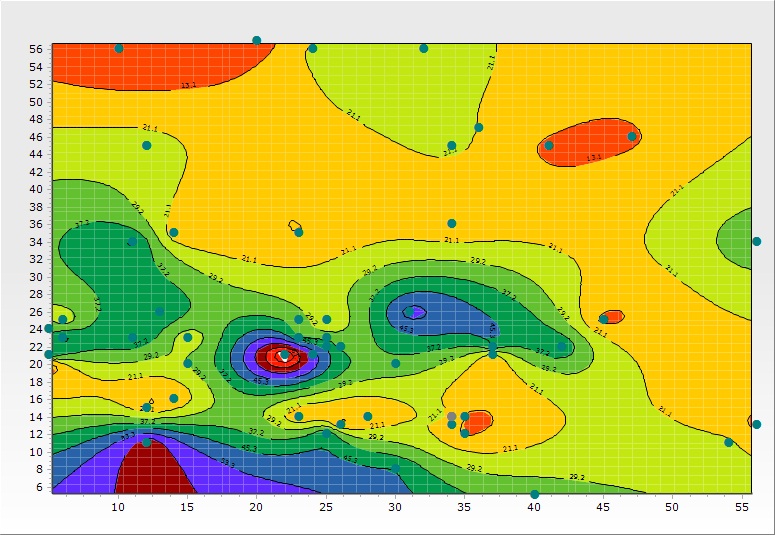

I have plotted some data on the contour and isosurface series. I have a problem with charts showing white grid lines. How can I remove the grid lines?

Hello lilo,
To achieve of grid of Contour and IsoSurface doesn't appear, you need set property Grid.Visible of axes Bottom and Left to false, as do in next simple example:
 Steema.TeeChart.Styles.Contour series1;
            ChartController1 = new Steema.TeeChart.ChartController();
            this.Controls.Add(ChartController1);
            ChartController1.Chart = tChart1;
            series1 = new Contour(tChart1.Chart);
            series1.FillSampleValues();
            tChart1.Axes.Bottom.Grid.Visible = false;
            tChart1.Axes.Left.Grid.Visible = false;
And also I think may be helpful know,that in case you use a IsoSurface, you can hide the BandPen doing something as next:
            tChart1.Series.Clear();
            tChart1.Aspect.View3D = true;
            Steema.TeeChart.Styles.IsoSurface isoSurface = new IsoSurface(tChart1.Chart);
            isoSurface.FillSampleValues();
            isoSurface.BandPen.Visible = false;
            isoSurface.IrregularGrid = true;
            tChart1.Axes.Left.SetMinMax(isoSurface.YValues.Minimum, isoSurface.YValues.Maximum);
Could you tell us, if previous code works as you expected?
I hope will helps.

I have set
but this has no effect on the contour and isosurface grid.

Also, they do not look like axes grid lines to me. They look more like the grid cell borders of the contour map.

I found the solution...Smoothingmode=highspeed.
Re: Grid lines on contour series
Post by Sandra » Tue Sep 27, 2011 10:03 am
Hello lilo,
Thank you for information. I have checked your suggestions to tChart1.Aspect.SmoothingMode = System.Drawing.Drawing2D.SmoothingMode.HighSpeed; and I consider it as a good solution to solve the problem.
