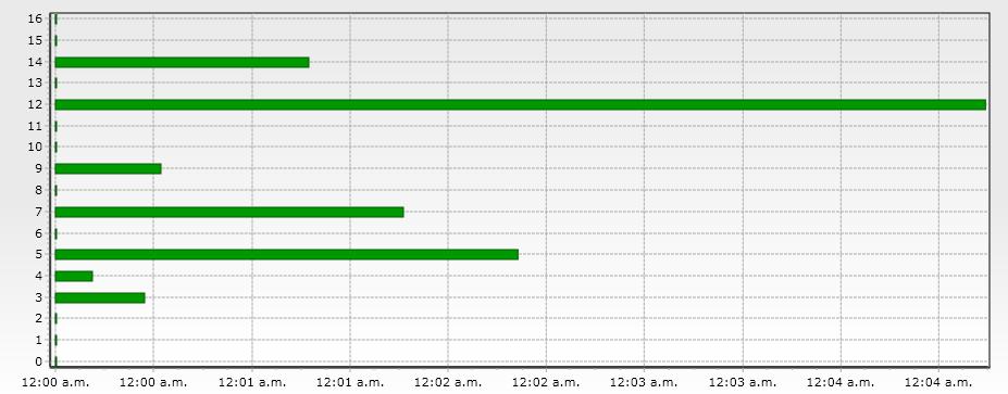

I need to make a time graph like the attached image but in vertical direction.
I need that in the left axe shows the time and the bottom axe shows a progressive number
And it could be better if is a line graph.
How can I do that?
Thanks!

I have made a simple example, where Y values are DateTime using method ToOADate() and I think next code help you to achieve as you want:
            InitializeChart();
            Steema.TeeChart.Styles.HorizBar horizBar = new Steema.TeeChart.Styles.HorizBar(tChart1.Chart);
            horizBar.YValues.DateTime = true;
            DateTime today = DateTime.Today;
            TimeSpan oneDay = TimeSpan.FromDays(1);
            for (int i = 1; i < 10; i++)
                    horizBar.Add(i,today.ToOADate(),Color.Green);
                    today += oneDay;
Could you please, tell us if previous code works fine to you?
I hope will helps.
