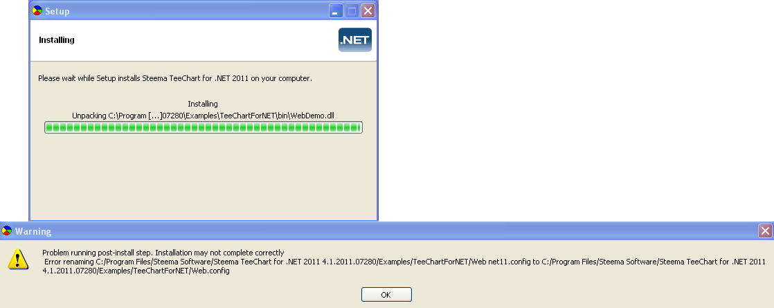

I think I've figured it out. The uninstall did not remove the folder (C:\Program Files\Steema Software\Steema TeeChart for .NET 2011 4.1.2011.07280), with the folder in place the installation fails. I removed the folder and retried the install and it got past the point of the previous failure. It is now throwing the following warning, but looks like it has installed the main components.
tchart03-08-2011 07-10-52.PNG (28.13 KiB) Viewed 16279 times

Re: Unable to install July 2011 release
Post by Sandra » Wed Aug 03, 2011 8:17 am
Hello Captell
It is a known problem for us and It is already in wish-list with number (TF02015643) and thanks for your information we consider this information to solve the problem.
