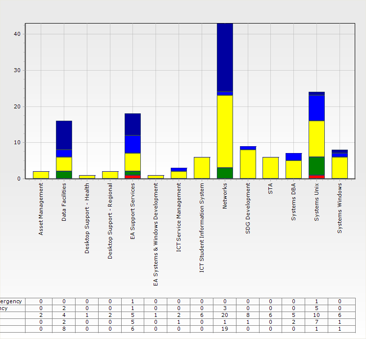

Post by Captell » Wed May 25, 2011 5:27 am

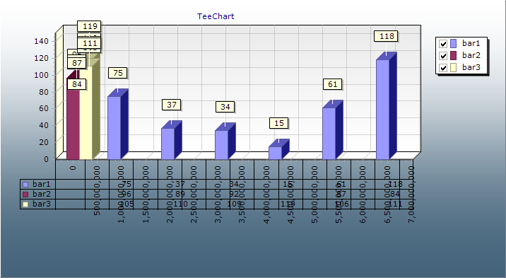

Hi There,
I'm using dot net version 4.1.2011.4190 in a vs2003 vb development environment and am having problems with the data table tool over writing the bottom axis labels. It appears that the issue occurs when the axis labels are more than a couple of characters long.
If you use your Feature demo and go to Welcome !\Tools\Data Table.
Double click the yellow portion of the window to get the TeeChart Editor up, go to the data tab and change the X values from 0,1,2,3,4,5 to 1111111111,2222222222,3333333333,4444444444,5555555555,6666666666 you will see what I mean.
I can't find any way to correct this, can you look into it please.

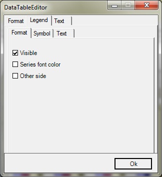

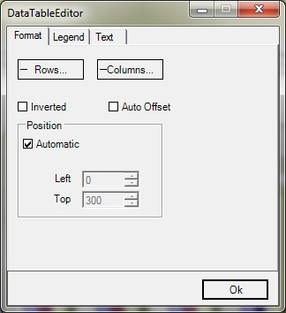

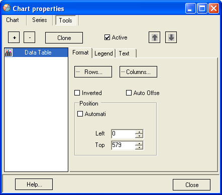

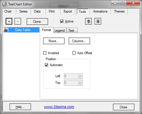

Also, The DataTableEditor dialog has many errors
on the Format tab, "Automati" and "Auto Offse"
Auto Offset once checked doesn't seem to do anything when unchecked.
on Legend tab, "Visibl", "Series font colo", "Other sid"
Legend Symbol tab has nothing on it.
Can these be correted please.

About DataTableEditor, for me seems work as I expected in:
on the Format tab, "Automati" and "Auto Offse" and Auto Offset once checked doesn't seem to do anything when unchecked.
On the other hand, I can see that you are right with tab of Legend Symbol and I have added it in wish-list as a bug report with number [TF02015588]. We will try to fix it to next versions of TeeChart.Net.

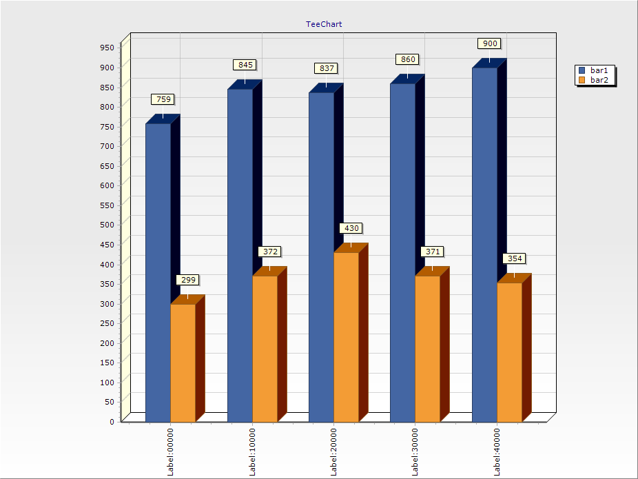

I see from your screen shots that your installations seems to behave a little different to mine, here is a simmilar screen shot showing the missing characters, any ideas on why it's different.
Also, can you explain what the Automatic offset is for. I have made changes to use custom position but the problem is that I also have to manually change the bottom label size otherwise the labels overwrite the data table. As my labels are dynamic, changing from chart refresh to chart refresh I have to set he label size big enough for the largest possible label which when they are all short makes lots of wasted space. I also have to set the size of the left axis labels quite large otherwise the start of the data table legend is cut off. This image shows the chart with the left axis labels set to the default of 0.
This image shows how I think the chart should look with Automatic Offset checked.
Can you have a look at these issues please.

I see from your screen shots that your installations seems to behave a little different to mine, here is a similar screen shot showing the missing characters, any ideas on why it's different.
31-05-2011 07-02-42.png (26.2 KiB) Viewed 53730 times
If I resize the window with the mouse I can see the datatable at the bottom but only briefly.
Also, this solution doesn't work if there are footnotes, the data table sits over the footnotes. I also won't work if the lavels are not at 90 degrees.
I've asked a couple of times before about datatable.AutoPosition, is not this property supposed to do this automatically for me. Also the Auto Offset property messes up the chart when clicked, unclicking it does not restore .
Can I please get an answer to this issue? My application allows the user to build and configure their own charts using the chart property editor. A coded workaround solution will not work as I don't know what the user will want before hand. To avoid the other issues with chart property editor such as offset and symbol page as described above I've turned off the Tools tab and have provided a separate menu to add data tables but I doubt I'll be able to provide a satisfactory code around to the positioning issue.
Adrian Heald
Director
