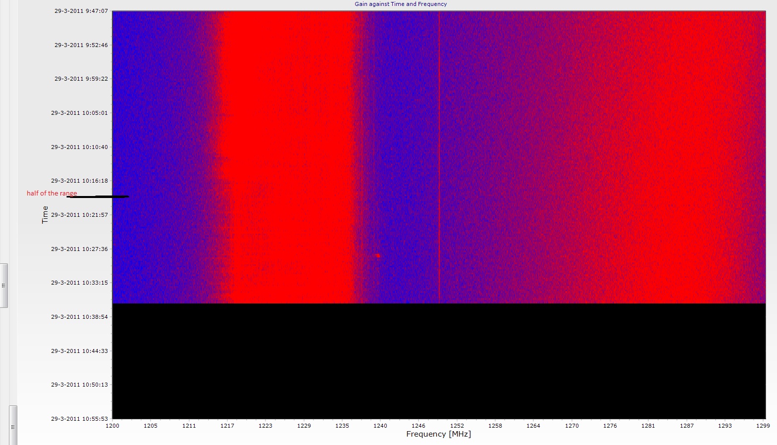

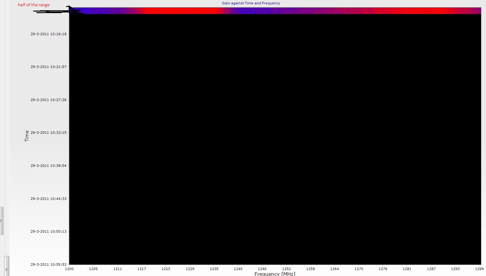

I'm currently working with a ColorGrid having quite some values, around 600000 in this example but the problem is reproductible with less values than that. When displaying the full range of the Y axis, in order to have every value displayed, everything is fine, but when trying to zoom or trying to make bigger anything under half of the Y range then the data is not displayed properly and stays black. Here are a few screenshots to make it more clear :
Initial display :
Full range, everything is fine
Reducing Y range :
Starting to reduce Y axis range, some data starts to be black
Reducing Y range more :
Reducing Y axis range, when reaching half of the range the whole displayed data is black.
When zooming anywhere under half of the range we have a similar behavior, every data being black.
