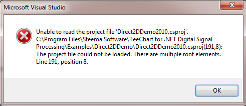

I just bought teechart 2010 and cannot load the project Direct2DDemo2010.csproj
I get the error message as shown in the attachment.
Any ideas?
I am running Windows 7 ultimate with Visual Studio 2010

- Visual Studio 2010 error message
- ErrorWhenLoadingProject.PNG (25.6 KiB) Viewed 16627 times

Hello Andrew,
I could reproduce it problem and I have solved it doing next steps:
I hope will helps.
- 1.- Open with text editor(notepad, notepad++,...) Direct2DDemo2010.csproj
2.- Remove next lines, that you will find end of file.3.- Try again to load project.Code: Select all
<HintPath>C:\Program Files\Steema Software\TeeChart for .NET Digital Signal Processing\net40\TeeChart.Direct2D.dll</HintPath> <HintPath>C:\Program Files\Steema Software\TeeChart for .NET Digital Signal Processing\net40\TeeChart.dll</HintPath>
4- Go to folder references and remove: TeeChart ,TeeChart.Direct2D
5.- Add again files TeeChart.dll and TeeChart.Direct2D.dll, that you find in the folder \...\Steema Software\TeeChart for .NET Digital Signal Processing\net40
6.- Clean solution and build it again
7.- Run project.
I hope will helps.

Hi Sandra,
Yes your suggestions worked and I can now compile and run the example.
