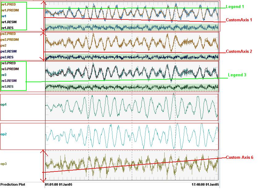

I want to use the TeeChart legend in a little different way. Please let me know if the below features can be achieved using TeeChart legend.
See the attached image from our existing product -
Green part as Legend Area and red is the Vertical Custom axis
Can we achieve this kind of feature using Teechart legend?
Can we use Multiple Legend controls?
We have to allign each of the legend controls with the Custom axis, thats very important.
While scrolling the chart, legend also should scroll accordingly (synchronized).
i had gone through the legend demos but no where found anything about alligning legends with the axis.
Custom positioning is possible but in that case we have to always maintain the positions of the legends and that needs to be very accurate.
For example after zooming, we increase the custom axis height. Then we have to handle the legend controls also separetly. We want to avoid that.
Is there anyway we can associate a legend with a axis?
Hope you understood my questions.
Please let me know if all these can be achieved using TeeChart legend.

In TeeChart VCL there is the TCustomLegendTool that may help you in this but I'm afraid it's not possible yet in TeeChart .NET.
So right now you could do it by yourself. As a start point you could use the custom legend proposed by Christopher, here.
