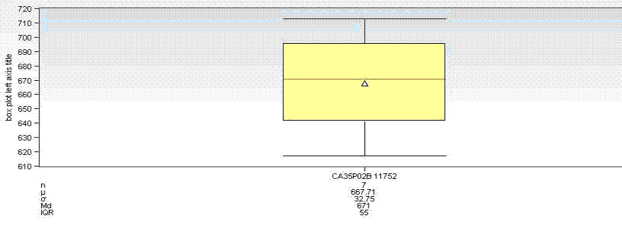

As you could see in the attached image, the box width is changed with the code, but the axis label angel is not changed.
Box Plot Width and Angel.GIF (9.96 KiB) Viewed 6912 times

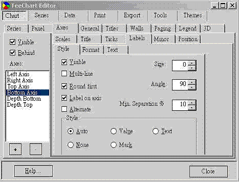

But we could see that the angel is changed to 90 in Chart Editor
angel in editor is changed.GIF (18.92 KiB) Viewed 6912 times
