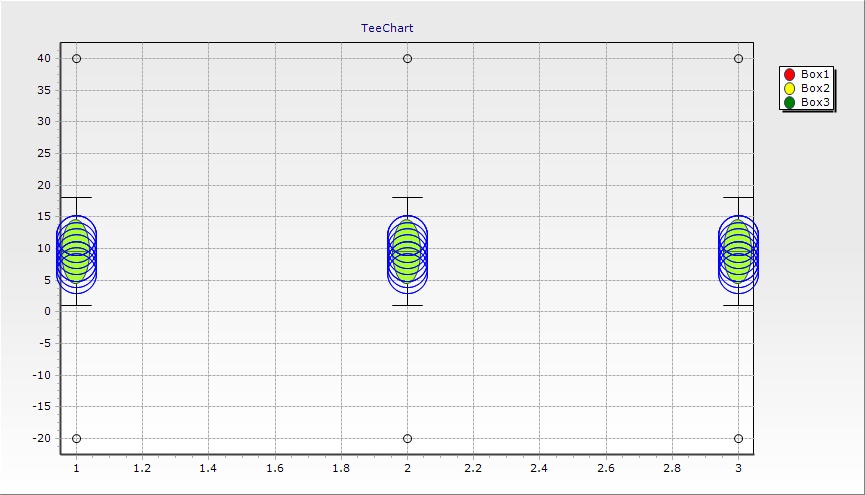

Hello Sandra,
I am facing problem with this code.
1. I am unable to select the 1st box
2. Unable to select the outlier points of each box.
3. When I select a box plot series , Its drawing only circle instead of highlighting the selected points.(The color of the points should be changed.)
How to exclude and include selected points and redraw the particular box from box series?
with regards,
Vivek J

Hello vivek,
I have made changes in last code I send you, and I think works correctly and you could use a similar code as next:

Please check previously code works fine. For check that works you have do next:
For select points:
Click with button Right and draw rectangle of size that you want and containing points.
For unselect:

Hello vivek,
1) Only the points at the Q1 of each box is getting selected and not all the points of the box.
I couldn't reproduce your issue, please see next image:
Unable to select the circular point of 1st box (which is in the rectangular box ) and change its color .
I couldn't reproduce your this problem:
If you want reproduce same with image, you could say what is your version of TeeChartFor.Net?
For select points:
For unselect:
Click with button Right in the canvas of your Chart and drop the mouse.
Here the Color of the box is getting changing when selected instead of changing the color of the point using which box plot is plotted.
I could reproduce your problem, and now, isn't possible paint only MidleOut of BoxPlot series, I have added your suggestion in Feauter Request with number[TF02014359] to regards in features versions of TeeChartFor .Net.
