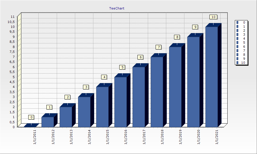

UserLS wrote:bring your chart editor and just change the bottom axis increment to your predefined option "One Year"
This can be done also by code with:
_testChart.Axes.Bottom.Increment = Steema.TeeChart.Utils.GetDateTimeStep(Steema.TeeChart.DateTimeSteps.OneYear);
With you code, and setting the Increment to "OneYerar" I get this:
And after adding the following line:
_testChart.Axes.Bottom.Labels.Style = Steema.TeeChart.AxisLabelStyle.PointValue;
I get this:
