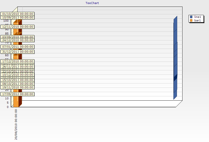

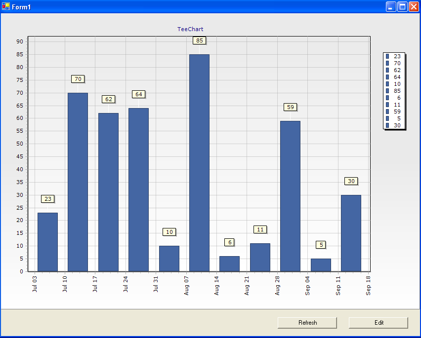

Ok, I think I've got a workaround now for the problem where labels don't align correctly with the bars, thanks.
I know you say this is by design but I really think you need to reconsider that design.
A bar graph by any definition I can find is primarilly used to show discrete values, and therefore the labels of those discrete values should align correctly with the bars. The example I've posted previously,
13-08-2010 9-13-27 AM.png (4.25 KiB) Viewed 104710 times
shows the left most bar with a label of 27/12/1999 when the data for that bar is 26/12/1999. To assume that the end user of this chart should know that because the label is ever so slightly to the right of the center of the bar they should extrapolate the dates to arrive at 26/12/1999 is quite ridiculous and forces the publication of charts that are plainly wrong.
Your workaround works but it means that the behaviour of bar charts (and I'm assuming horizontal bar charts too) is different to any other charts. When a user creates a line graph they can use dates as the xvalues, choose an increment and the data is displayed correctly. For instance they may want to plot weekly data but only show a label monthly for the first of the month, in this case they just set the increment to one month and it just works. This is not possible with bar charts.
The attempted fix providing the offset values is no fix at all as the offset only works with a set chart size, resize the window that the chart resides in and the labels don't align again. We now have an extra property to explain to the end users as something they should just ignore.
I am fully aware that it's up to you guys to determine how your products function and what the design is, I'm a developer and have clients that bug me for fixes and enhancements so I know what it's like but I really think in some cases the end user is correct. I challange you to find anyone that thinks the example chart shown above is correct when they understand that the data for that first bar is 26/12/1999.
Please reconsider this design and allow a simple, reliable and consistant way of providing x,y data to a bar chart when X is a datetime value, with a result that the labels correctly align with the bars.

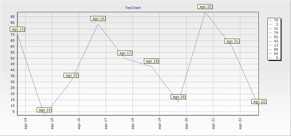

I can see the same behaviour we described with Line series. Adding the points with datetime and without labels, the labels aren't aligned:
            Steema.TeeChart.Styles.Line line1 = new Steema.TeeChart.Styles.Line(tChart1.Chart);
            line1.Marks.Style = Steema.TeeChart.Styles.MarksStyles.XValue;
            line1.Marks.Visible = true;
            tChart1.Axes.Bottom.Labels.DateTimeFormat = "MMM dd";
            tChart1.Axes.Bottom.Increment = Steema.TeeChart.Utils.GetDateTimeStep(Steema.TeeChart.DateTimeSteps.OneDay);
            Random rnd = new Random();
            DateTime date = DateTime.Now;
            for (var i = 0; i < 10; i++)
                line1.Add(date.AddDays(i), rnd.Next(100));
            line1.XValues.DateTime = true;

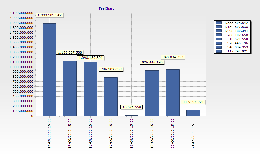

You are adding the bar series values without XValue. This makes the XValues to be 0, 1, 2,... And you are adding the line series values with XValues, DateTime XValues that would probably be around nowadays so they have values about 40000 approximately. So I'm afraid it would be an expected behaviour because your bar series XValues and your line series XValues are very far.
The resizing problem may be different. That's why I created a new ticket for it
On the other hand, I still think that the best way to achieve what you are trying would be the code I proposed here. If the only proble you have with it is that it doesn't allow to view the effect of manipulating the Increment, here you have a variant:
            CreateChart();
            InitializeChart();
        private Steema.TeeChart.TChart tChart1;
        private int ant;
        private void CreateChart()
            tChart1 = new Steema.TeeChart.TChart();
            this.Controls.Add(tChart1);
            Steema.TeeChart.ChartController chartController1 = new Steema.TeeChart.ChartController();
            //Steema.TeeChart.Commander chartController1 = new Steema.TeeChart.Commander();
            this.Controls.Add(chartController1);
            chartController1.Chart = tChart1;
            chartController1.Dock = DockStyle.Top;
            Steema.TeeChart.Styles.Bar bar1 = new Steema.TeeChart.Styles.Bar(tChart1.Chart);
            bar1.Marks.Style = Steema.TeeChart.Styles.MarksStyles.XValue;
            tChart1.Axes.Bottom.Increment = Steema.TeeChart.Utils.GetDateTimeStep(Steema.TeeChart.DateTimeSteps.TwoDays);
                bar1.Add(date.AddDays(i), rnd.Next(100));
            bar1.XValues.DateTime = true;
            tChart1.Axes.Bottom.Labels.Style = Steema.TeeChart.AxisLabelStyle.Text;
            tChart1.Panel.MarginBottom = 15;
            tChart1.GetAxisLabel += new Steema.TeeChart.GetAxisLabelEventHandler(tChart1_GetAxisLabel);
        void tChart1_GetAxisLabel(object sender, Steema.TeeChart.GetAxisLabelEventArgs e)
            if (sender == tChart1.Axes.Bottom)
                if ((e.Series != null) && (e.ValueIndex > -1))
                    if (e.Series.FirstVisibleIndex == e.ValueIndex)
                        e.LabelText = DateTime.FromOADate(e.Series.XValues[e.ValueIndex]).ToString("MMM dd");
                        ant = e.ValueIndex;
                    else if ((ant != -1) && (e.Series.XValues[ant] + tChart1.Axes.Bottom.Increment <= e.Series.XValues[e.ValueIndex]))
                        ant = e.ValueIndex;

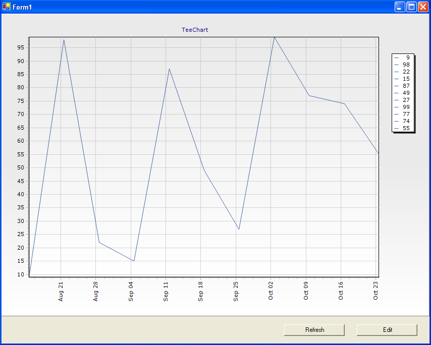

I just tried something from your statement
The following code correctly aligns the labels, the dates are added to the chart as DOUBLE, all chart properties functionality works correctly, i.e. label formats, increments etc. resizing the window has no detrimental effect... so here all is well.
Private Sub InitializeChart()
      TChart1.Aspect.View3D = False
      Dim line1 = New Steema.TeeChart.Styles.Line(TChart1.Chart)
      TChart1.Axes.Bottom.Labels.Angle = 90
      TChart1.Axes.Bottom.Labels.DateTimeFormat = "MMM dd"
      TChart1.Axes.Bottom.Increment = Steema.TeeChart.Utils.GetDateTimeStep(Steema.TeeChart.DateTimeSteps.OneWeek)
      Dim Rnd = New Random
      Dim d As Double = 40000
      For i As Integer = 0 To 10
         line1.Add(d, Rnd.Next(100))
         line1.XValues.DateTime = True
         d = d + 7
      Next
Yet the following doesn't, same as previous chart and example except using a bar series, so here is evidence that there is something different between bar and line.
      Dim bar1 = New Steema.TeeChart.Styles.Bar(TChart1.Chart)
         bar1.Add(d, Rnd.Next(100))
         bar1.XValues.DateTime = True
         d = d + 7
      Next

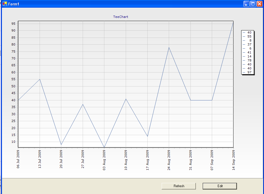

going back to the line example, if you change it to add the X value as a date it doesn't correctly align, so here is evidence that there is something wrong with the way labels are aligned when they are added as date time.
Dim dte As DateTime = DateTime.Now
line1.Add(dte, Rnd.Next(100))
dte = dte.AddDays(7)
Next

Captell wrote:The following code correctly aligns the labels, the dates are added to the chart as DOUBLE, all chart properties functionality works correctly, i.e. label formats, increments etc. resizing the window has no detrimental effect... so here all is well.
Captell wrote:Yet the following doesn't, same as previous chart and example except using a bar series, so here is evidence that there is something different between bar and line.
The explanation is that a point in the Bar series is quite wider than the Line series points. Try the following in your firs example:

Re: X asix labels not lining up properly
Post by Yeray » Wed Sep 08, 2010 8:15 am
Hi Captell,
While we study the convenience of this new property, you may be interested in trying another possibility:
            tChart1.Axes.Bottom.Labels.Style = Steema.TeeChart.AxisLabelStyle.Mark;
Using MarksStyles.XValue and AxisLabelStyle.Mark aligns the axis labels with the bars but, of course forces you to show the same in the points marks and in the axis labels (or to hide the points marks).
Post by Yeray » Tue Sep 14, 2010 8:06 am
Hi Captell,
We've added a new AxisLabelStyle, named PointValue meaning mandatory ValueList value displaying on the axis which is associated with the notMandatory ValueList (notMandatory is XValues in Bar or Points Series and is associated with Bottom Axis by default).
So the following can be done (also through the editor):
        private Steema.TeeChart.Styles.Bar series;
            series = new Steema.TeeChart.Styles.Bar(tChart1.Chart);
            series.XValues.DateTime = true;
            DateTime date = DateTime.Parse("14/09/2010 15:00");
            for (int i = 0; i < 8; i++)
                series.Add(date.AddDays(i), rnd.Next());
            tChart1.Axes.Bottom.Labels.DateTimeFormat = "dd/MM/yyyy HH:mm";
            tChart1.Axes.Bottom.Labels.Style = Steema.TeeChart.AxisLabelStyle.PointValue;
