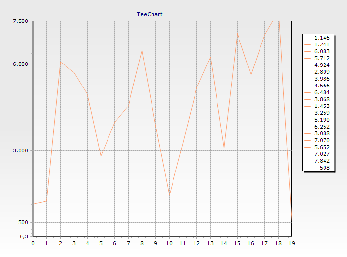

In the earlier trend image Y-axis is showing minimum value as 500. Even if I have set it to 0.3 in code. I am expecting Y-axis should be started from 0.3 (min) to 7500 (no issue with max value it is setting correctly). Basically I don't want chart to auto calculate values based on scale.

One thing is the Axis.Minimum and Axis.Maximum, and another thing are the Axis labels. You can see that SetMinMax works using test code such as the following:
      Line line = new Line(tChart1.Chart);
      Random rnd = new Random();
      for (int i = 0; i < 20; i++)
        line.Add(i, rnd.Next(0, 8000));
      tChart1.Axes.Left.SetMinMax(0.3, 7500);
      tChart1.GetNextAxisLabel += TChart1_GetNextAxisLabel;
    private void TChart1_GetNextAxisLabel(object sender, GetNextAxisLabelEventArgs e)
      if (((Steema.TeeChart.Axis)sender).Equals(tChart1.Axes.Left))
        e.Stop = false;
        switch (e.LabelIndex)
          case 0:
            e.LabelValue = 0.3;
            break;
          case 1:
            e.LabelValue = 500;
            break;
          case 2:
            e.LabelValue = 3000;
            break;
          case 3:
            e.LabelValue = 6000;
            break;
          case 4:
            e.LabelValue = 7500;
            break;
          default:
            e.Stop = true;
            break;
which gives us:

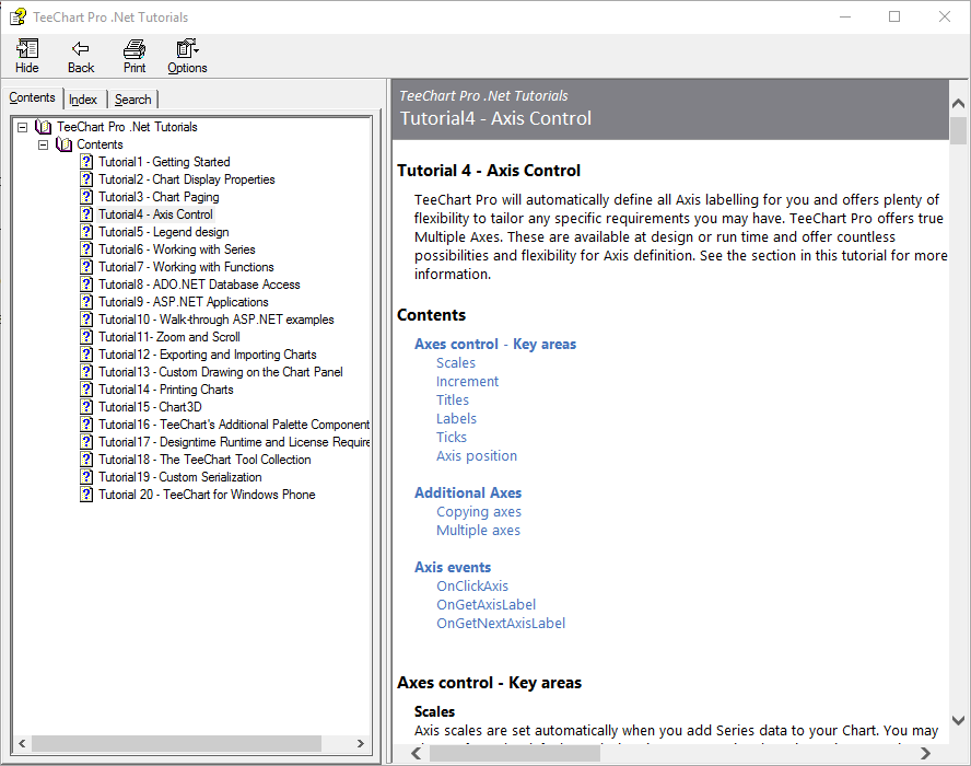

This axis functionality is explained in the tutorials shipped with TeeChart.NET:
