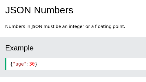

Okay. The JSON Data Types are these, which are the essentially the same as system.text.json.jsonvaluekind. For TeeChart, we need a number and a string, so we can use this enum to extract a number and a string. As you can see, there are only two types of numbers in JSON:
Screenshot from 2023-02-15 15-52-04.png (14.69 KiB) Viewed 7348 times
This means that numbers can only be Int32 or Double. Internally, TeeChart holds data in the Double type, and as JSON number values can all be converted to double, this means that the following code will cover all number types (you can see it working for both Int32 and Double values):

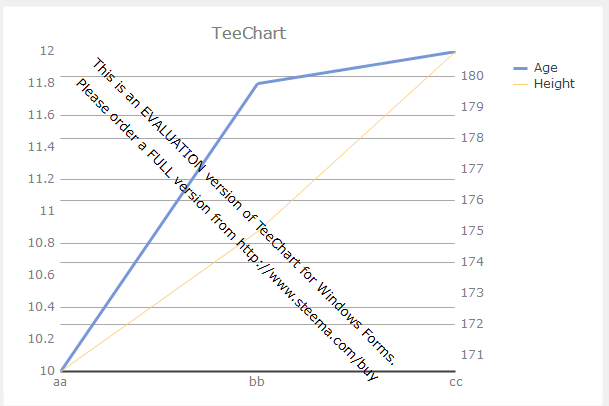

            var age = new Line(tChart1.Chart);
            age.YValues.DataMember = "Value";
            age.LabelMember = "Name";
            age.Title = "Age";
            age.LinePen.Width = 3;
            age.Add(GetData("[\"name\",\"age\"]") as IList);
            var height = new Line(tChart1.Chart);
            height.YValues.DataMember = "Value";
            height.LabelMember = "Name";
            height.Title = "Height";
            height.Add(GetData("[\"name\",\"height\"]") as IList);
            height.VertAxis = VerticalAxis.Right;
