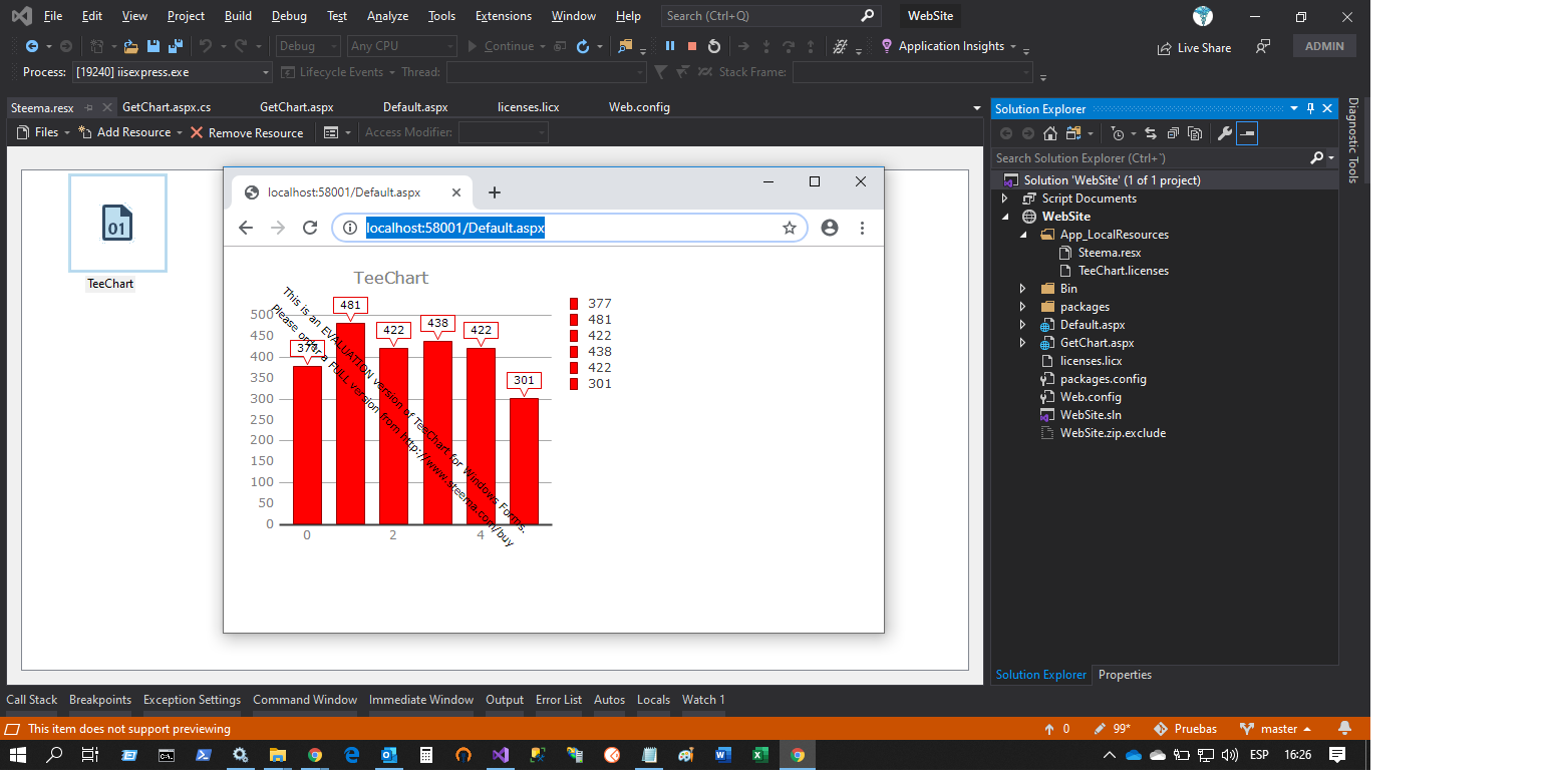

Hi, I made further research and found that a simple page with a teechart doesn't works ok.
I've attached a simple demo (without bin folder, packages folder nor Teechart.licences) that I cannot make it works fine.
Could you make it works and say me what is missing?

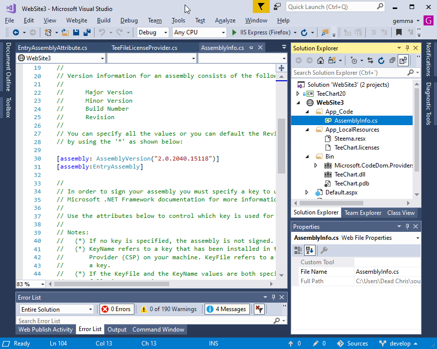

I think this project was missing an AssemblyInfo.cs with the necessary EntryAssembly attribute in it:

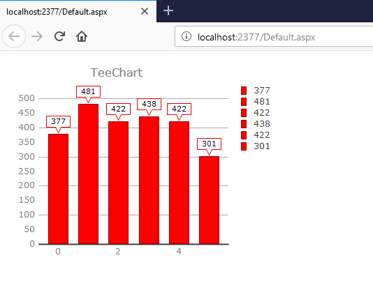

With this added in the watermark disappears:

Hello, with this added, not only the sample but my site has also been fixed.
