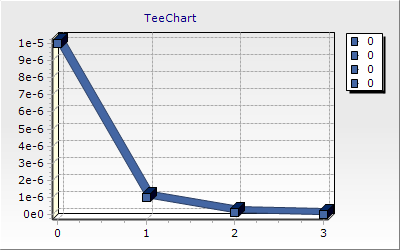

Also, something wrong with X values being zero occurs in this chart. Bottom axis minimum setting is necessary to get something similar to you original chart:
      tChart1.Axes.Bottom.AutomaticMinimum = false;
      tChart1.Axes.Bottom.Minimum = 1e-5;
Which produces this:

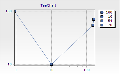

I'm afraid this is a problem with low log axis increments, which can be narrowed to this:
            tChart1.Axes.Bottom.Logarithmic = true;
            tChart1.Axes.Left.Logarithmic = true;
            Steema.TeeChart.Styles.Line line1 = new Steema.TeeChart.Styles.Line(tChart1.Chart);
            line1.Pointer.Visible = true;
            line1.Add(0, 100);
            line1.Add(0.000001, 10);
            line1.Add(0.0001, 54);
            line1.Add(0.01, 70);
            //Workaround
            //tChart1.Axes.Bottom.AutomaticMinimum = false;
            //tChart1.Axes.Bottom.Minimum = 1e-10;
I'll add this to the bug list (TF02015020) to be enhanced.

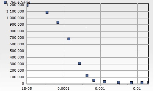

I understood that [TF02015020] is due to the wrong axis labels (LogBottomMin.png). BTW, this problem can temporary be reduced by chosing "", "g" as label format.
But I think that auto scaling should work with logarithmic scales and series having datavalues <= 0 should work, too. So if this is not covered by [TF02015020} I would suggest to make a new entry in your bug list.
And now the good news: Logarithmic axes seem to work with the new assembly, switching between lin/log scale is possible! Calculation of axis values within the mouse move event is correct.

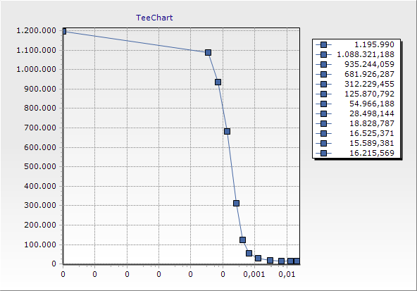

The next image displays the data of test_1.txt:
Here are the point data:
0 1195990
3.486E-5 1088321.18811881
6.937E-5 935244.059405941
0.0001374 681926.287128713
0.0002696 312229.455445545
0.0004279 125870.792079208
0.0006663 54966.1881188119
0.001289 28498.1435643564
0.003094 18828.7871287129
0.00696 16525.3712871287
0.0135 15589.3811881188
0.02082 16215.5693069307

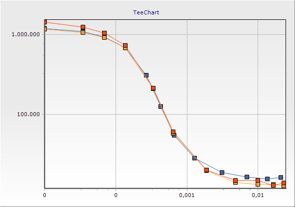

If you compare these data with the chart then it's obvious that the point with x=0 is drawn at x=axes.bottom.minimum! That's crazy!
And I think its also true for your LogBottomMin.png. It's hard to see since there is a logarithmic y axis but at x=1e-5 should be no point. Please could you provide a fix asap since I urgently need to work with my application!

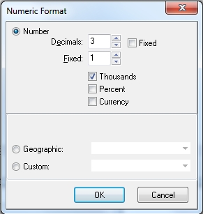

Another thing what I'm wondering about: With axes label format "00e-0" (applied from chart editor) I get axes labels which are wrong for a factor of 10: For instance, instead of "1e-5" the label is displayed as "10e-6". Possibly, this might be intentionally since 10*1e-6=1e-5 but here I do not know anyone thinking so. End user might be confused. So the question is: Is there a possibility to edit the list of default label strings?
Best regards
I may not be getting your point here. However, using this code:
      //tChart1.Axes.Left.Logarithmic = true;
      tChart1.Axes.Bottom.Minimum = 0.000000001;
      line1.Add(0, 1195990);
      line1.Add(3.486E-5, 1088321.18811881);
      line1.Add(6.937E-5, 935244.059405941);
      line1.Add(0.0001374, 681926.287128713);
      line1.Add(0.0002696, 312229.455445545);
      line1.Add(0.0004279, 125870.792079208);
      line1.Add(0.0006663, 54966.1881188119);
      line1.Add(0.001289, 28498.1435643564);
      line1.Add(0.003094, 18828.7871287129);
      line1.Add(0.00696, 16525.3712871287);
      line1.Add(0.0135, 15589.3811881188);
      line1.Add(0.02082, 16215.5693069307);
I get this chart:
I don't see anything wrong with it (besides TF02015020). I think it's correct plotting a point at X=0 since one of the data points in the series is added like this:
Is that what you mean? if not, could you please give us more details about the issue?
Yes, you can use GetAxisLabel event for that, for example:
    void tChart1_GetAxisLabel(object sender, Steema.TeeChart.GetAxisLabelEventArgs e)
      if (sender.Equals(tChart1.Axes.Bottom))
        double tmp = Convert.ToDouble(e.LabelText);
        tmp *= 10;
        e.LabelText = tmp.ToString();

Of course, no question. But I must be able to display series (not points) containing data with x<=0 on a logarithmic x axis. In this case, of course, points with with x<=0 must not be displayed. So I will have displayed only the points with x>0. For these points with x>0 autoscaling should work (That's the way my own old Delphi chart component works). So I need nothing to display points with x<0.
No, that's not correct: X axis minimum is not 0. See your own citation above: log(0) is not defined. But the point with x=0 is drawn at
x = tChart1.Axes.Bottom.Minimum (= 0.000000001)
This must not be! Points with x<= 0 can not be displayed with a logarithmic x axis!

According to MSDN's Custom Numeric Format Strings entry, to get what you request you sould use this ValueFormat set to "0e-0" as in this example:
            line1.Add(1e-5);
            line1.Add(1e-6);
            line1.Add(1e-7);
            line1.Add(1e-8);
            tChart1.Axes.Left.Labels.ValueFormat = "0e-0";
Which produces this chart:

As I understand that: To each series (I work mostly with line, point and fastline) I have to add a handler. Within my application the different kinds of series were created in a lot of different classes (around 20, I think), if required they were copied or converted to another style and so on. Besides the huge amount of work, I expect the possibility to introduce new bugs by myself, performance problems (some series may have 100000 or more points and I have to check it for each pointer, during re-conversion in the else part of the first example I have to determine which pointer is used). And I have already perfomance problems: The implementation of the workaround for bug [TF02014992] requires to paint the chart two times before getting the required apperance (Until now I have not found a better way...). And after STEEMA will have fixed this I have to convert the code back again with the same huge amount of time and bug possibilities...
So I ask you to provide a new assembly with this bug fixed as soon as possible: With this chart behavior I can not start real world use!
In that case, settings points to be null it would be a much easier workaround for you to implement. For performance reasons it would be more efficient setting X=0 points to null when adding them to the series, for example:
      line1.Add(0, 1195990, Color.Transparent);
I'll post an update here when we have news about TF02015021.
Yes, I understand what you mean. But my concerns are the editing possibilities of the end user by means of the chart editor at run time: the end user is not a programmer and therefore not familiar with MS numeric format specification. I showed the axis labeling with "00e-0" three colleagues: they assumed "10e-6" as 1e-6 (they assumed it to be comparable to 10^-6). What I mean is: I do not like to present an ambigeous label format to the end user. And therefore I'm looking for the possibility to edit the list of default label strings. BTW, it would be a good idea to present format strings in the chart editor in dependence on the axis min/max values.
The string format of a double is independent of a double's value, that is, any value of a double can be displayed in any string format as explained here:
http://msdn.microsoft.com/en-us/library/kfsatb94.aspx
Having that in mind, how do you think such a feature should work? Adding a custom numeric format dialog for axis labels, as in the VCL version (see image below), would do the job?
This is the VCL editor.
