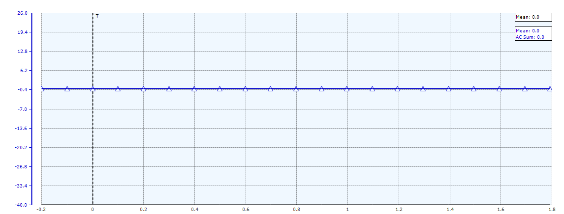

In my app, I create a custom Y-axis like this:
        public static Axis CreateCustomYAxis(SignalVectorPair svPair)
            var color = ChartDataToZData.MColorToDColor(svPair.VectorM.Color);
            var yAxis = new Axis
                Visible         = false,
                Horizontal      = false,
                Grid            = { Visible = false },
                Labels          = { Font = { Color = color } },
                AxisPen         = { Color = color, Visible = true, Width = 2 },
                Ticks           = { Color = color, Visible = true },
                PositionUnits   = PositionUnits.Pixels
            if (!string.IsNullOrEmpty(svPair.VectorM.Units))
                yAxis.Title.Text        = $"[{svPair.VectorM.Units}]";
                yAxis.Title.Angle       = 90;
                yAxis.Title.Font.Color  = color;
                yAxis.Title.Font.Size   = yAxis.Labels.Font.Size;
            yAxis.SetMinMax(svPair.SignalM.MinOrFactor, svPair.SignalM.MaxOrOffset);
            return yAxis;
I'm manually setting the Y-axis labels whenever needed (e.g., on zoom, pan, new data, etc.).
Up until now, I handled zooming using the middle mouse scroll. But now I've added support for your default zoom tool (click-and-drag rectangle).

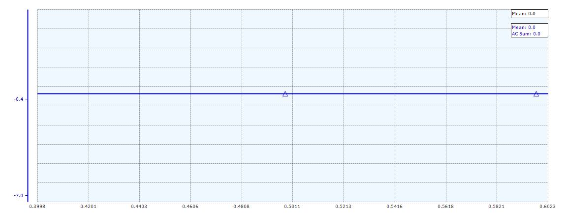

I'm using the Zoomed and UndoneZoom events to re-apply the Y-axis labels, and the events do fire correctly. However, after zooming, the labels appear corrupted — even though debugging confirms they are being set as expected.
I've attached two images:
Before zoom: Y-axis shows 11 labels (as intended).
After zoom: Even though I reset the labels to 11, the axis doesn't render them correctly.
Any idea what could be causing this?
Thanks!
Edu
Posts: 51
Re: Issue with Custom Y-Axis Labels After Using Default Zoom
Post by Edu » Mon Mar 31, 2025 11:02 am
Hello TomAgos,
Could you check whether your axis.Increment is set at 0 (automatic)? If so, try assigning a value that better fits your scenario.
If adjusting the Increment value doesn't resolve the issue, please share the code that triggers when zooming. I haven’t been able to replicate the problem naturally on my end, so testing your specific implementation would help me investigate further and assist you more effectively.
