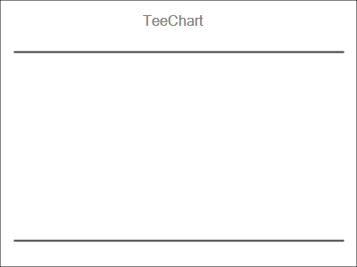

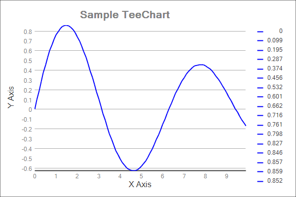

We are exporting our chart with data to .ten format using .NET version of Teechart. Later when we import the .ten file back to chart and save it as an image, the series data is missing. But saving the image directly works fine and renders well. I've replicated this issue in a sample .NET framework 4.8 console application and here's the code for the same. Also find attachments , one for image which is directly exported to PNG and the other which is imported from ten and then saved to image. Am I missing something?

Hello:
From a console application, please use the class TChart to access Export functionality. While the class 'Chart' does the job with UI Frameworks like Winforms, it is limited when it comes to console apps.
Here's how the code would look like, following the code you provided, instead of "Chart chart1 = ...".
            //suggested code
            TChart chart2 = new TChart();
            chart2.Import.Template.Load(fileName);
            chart2.Export.Image.PNG.Save("Chart2.png");
If there's anything else I can help you with, please let me know!
