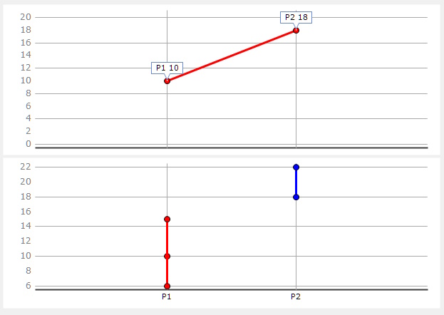

Not sure, I thought I had understood correctly. That the goal is to line up the charts (?). The principle is the same in this case. To modify chart settings to obtain the required result.
ie.
Very unrefined code to achieve these charts is included here:

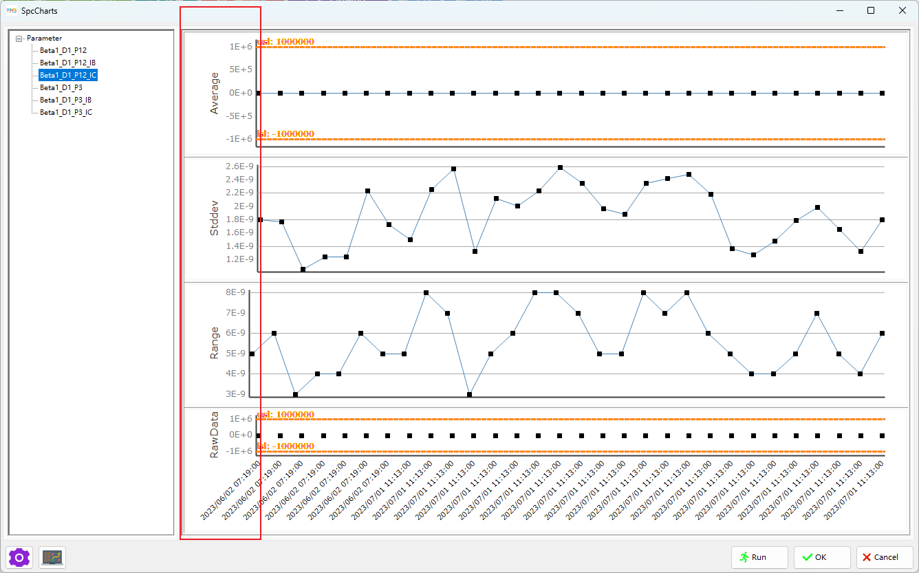

Question1:How do I find the maximum distance to the left of four graphs and set this maximum distance for all graphs
four chart.png (58.99 KiB) Viewed 31915 times

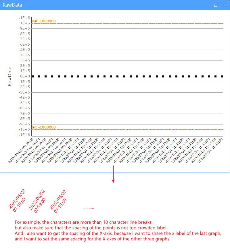

Question2:The X-axis label in the last figure is too long. I hope it can be displayed as a line wrap if it is too long, and the spacing between X-axis points and points can be widened
Line feed example.png (62.38 KiB) Viewed 31915 times

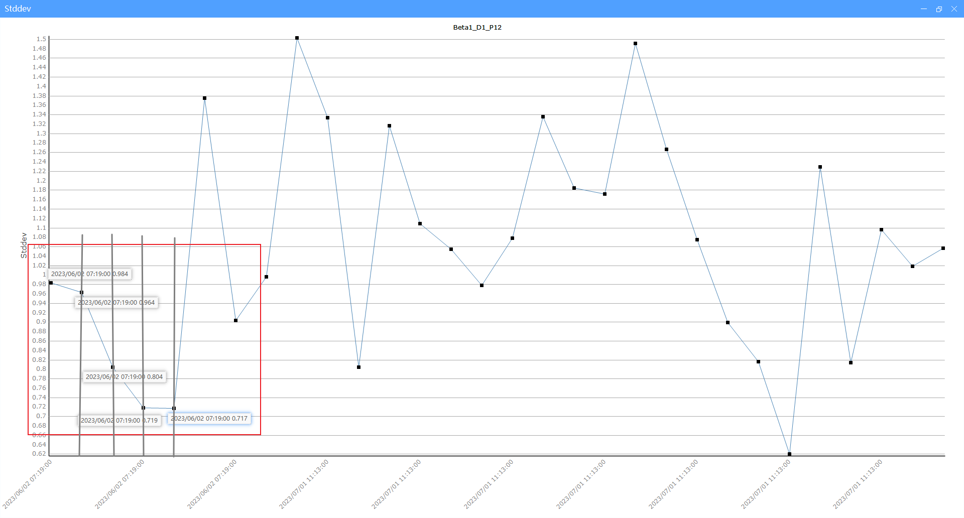

The X-axis names of the first five points in the red box are the same, I hope that each point can correspond to its own X-axis label, and then each point should have vertical lines, such as the gray line I hand-painted in the red box (it should be tchart.Axes.Bottom.Grid), I expect that each point has a corresponding X-axis. And they all have Axes.Bottom.Grid
