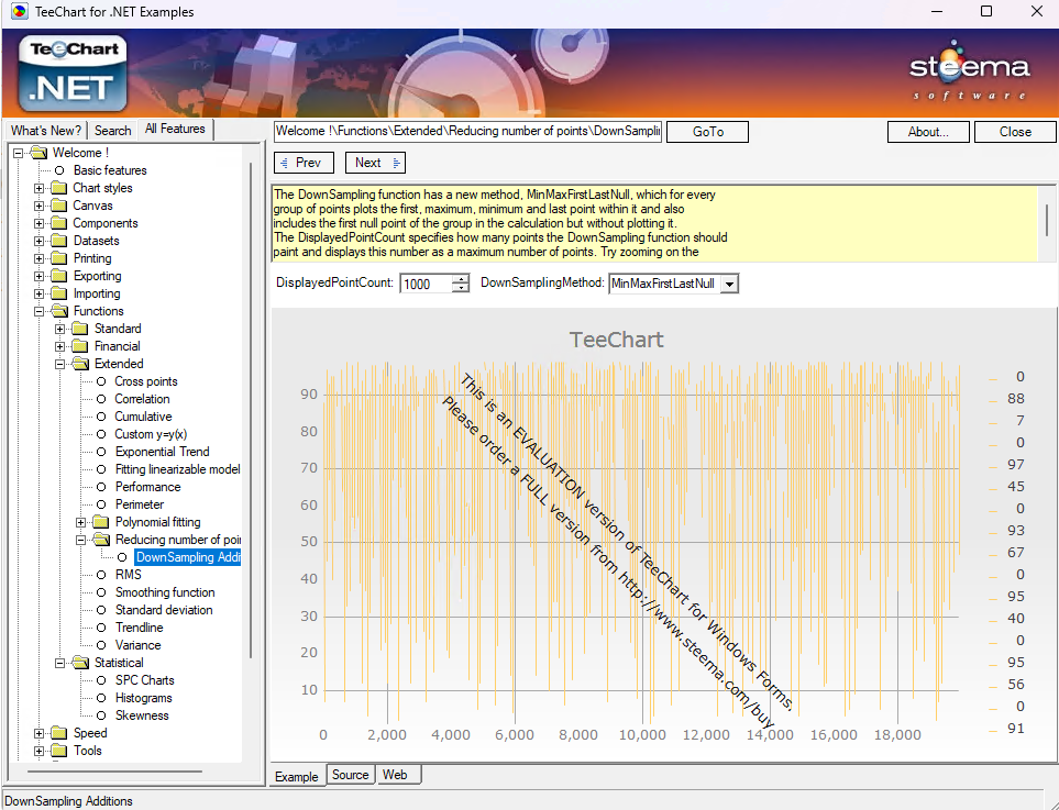

In that case, with reference to the two examples I pointed you to in my last post, you should look a the DownSampling function:
Screenshot from 2023-02-08 09-48-31.png (214.27 KiB) Viewed 8859 times
