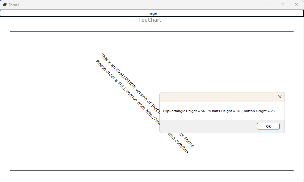

I obtain this:
Screenshot from 2023-01-26 15-49-30.png (21.5 KiB) Viewed 9557 times

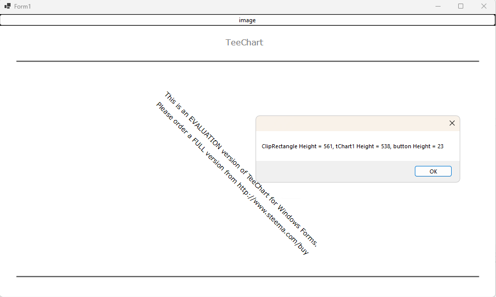

Whereas with this code:

I obtain this:
Screenshot from 2023-01-26 15-53-28.png (20.16 KiB) Viewed 9557 times
This helps us to understand what is happening. When we add the Button to the Form's Controls collection _after_ we add the Chart, the Chart's Height area is reduced by the Height of the Button. When we add the Button to the Form's Controls collection _before_ we add the Chart, the Chart maintains the same Height as the Height of the Form's ClipRectangle. When the Chart's Height is reduced, we obtain the black rectangle, and when the Chart's Height isn't reduced we do not.

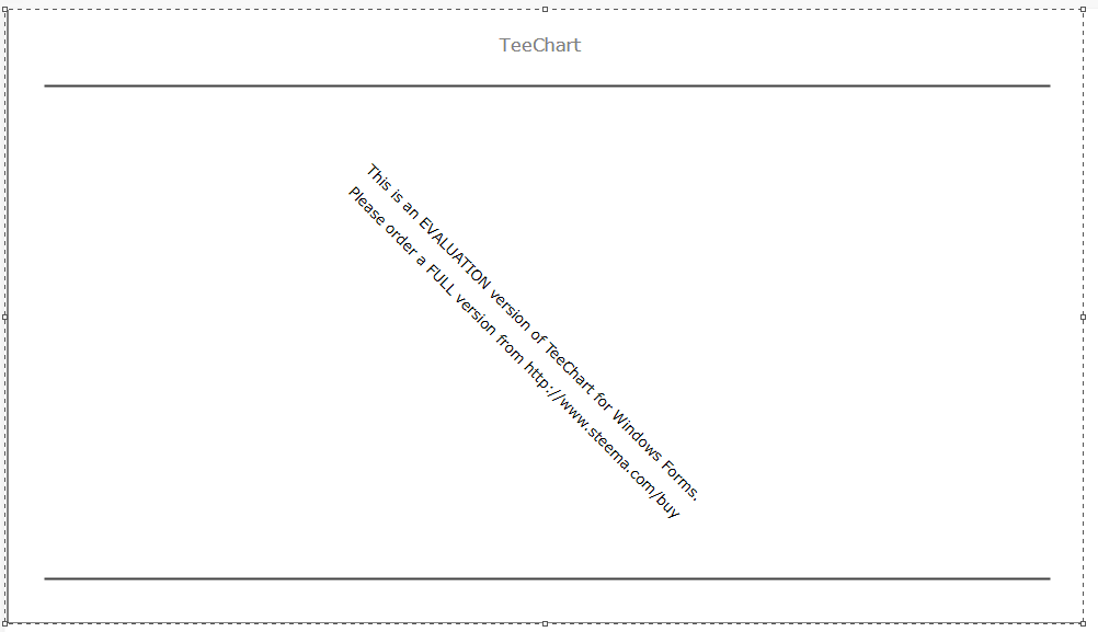

gives me this image when I click the button:
Screenshot from 2023-01-27 09-42-46.png (17.5 KiB) Viewed 9519 times

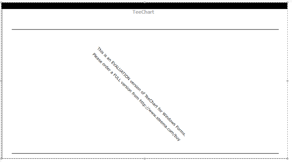

Whereas this code:

gives me this image:
Screenshot from 2023-01-27 09-43-52.png (17.63 KiB) Viewed 9519 times

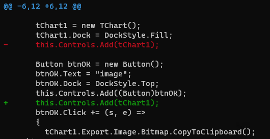

The difference between the code that gives me the bad image and the code that gives me the good image is a single line:
Screenshot from 2023-01-27 09-45-38.png (23.93 KiB) Viewed 9519 times
