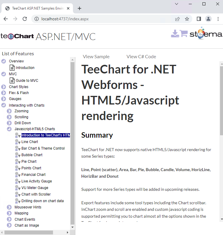

We have a Website project example in one of our GiHub repos for .NET Framework 4, which you can see here:
https://github.com/Steema/TeeChart-NET- ... %20WebDemo
Are any of the techniques shown there helpful to you? We would especially recommend working with our Javascript-HTML5 chart: Please let us know, with code examples if possible, what exactly you would like to achieve.
