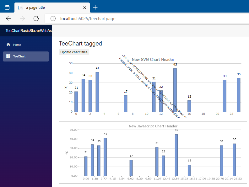

I'm trying to user TeeChart for Blazor and I'm following your example from https://github.com/Steema/TeeChart-NET- ... ebAssembly.
Without license file, the SVG chart shows the evaluation watermark, while the JS version does not show such a watermark.
After adding my TeeChart.licenses file to the project as embedded resource, this behaviour does not change, see attached screenshot.
So, can you please
1) confirm that no license is necessary to use the JS version of the chart component, and
2) tell me how to remove the watermark for the SVG version?
Ansgar
2022-08-23 16_13_40-Window.png (42.73 KiB) Viewed 5517 times

a colleague here tells me that a new TeeChart.licenses file has been sent to you, which we hope will resolve your issue.

Post by AHellwigAuer » Wed Aug 24, 2022 12:11 pm
Hello Christopher,
thanks for the new license file which I could successfully activate.
Unfortunately, the watermark is still present with the new TeeChart.licenses file.

Post by Christopher » Thu Aug 25, 2022 1:46 pm
Apologies for this mistake. I believe my colleagues have sent you another TeeChart.licenses file which I've checked works correctly.
