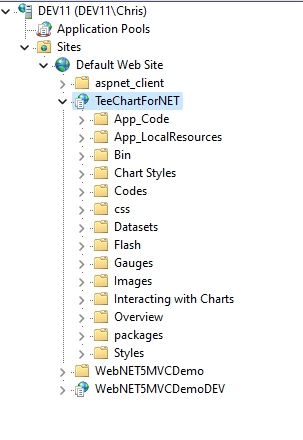

1. Add an application to your IIS:
Screenshot from 2022-05-30 14-52-28.png (18.22 KiB) Viewed 8037 times

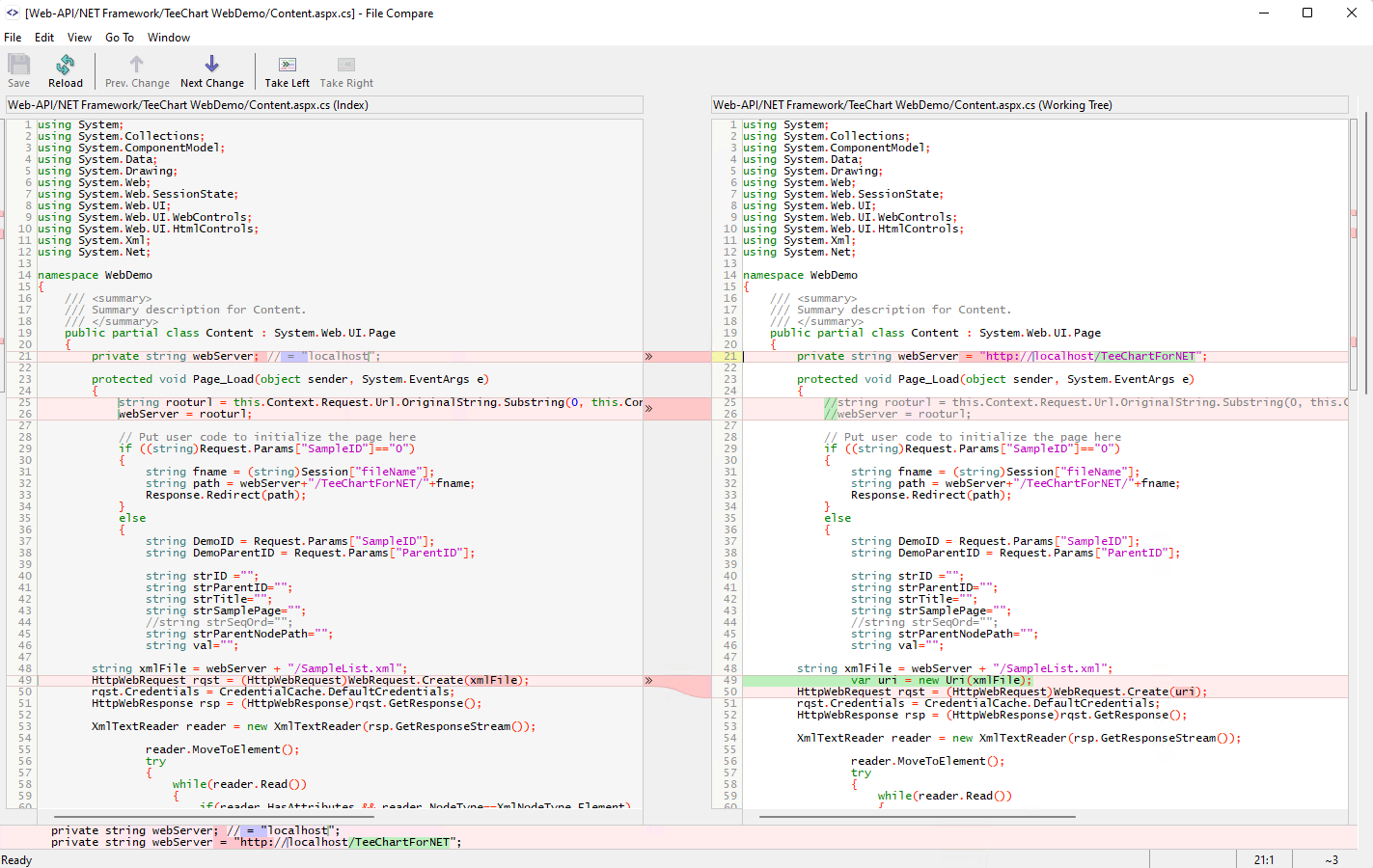

2. Modify the source code of Content.aspx.cs so it looks like this (make sure the 'webServer' variable has the same name as the IIS share):
Screenshot from 2022-05-30 14-35-55.png (195.97 KiB) Viewed 8037 times

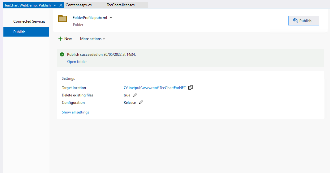

3. Use Visual Studio to publish the app:
Screenshot from 2022-05-30 14-55-00.png (22.29 KiB) Viewed 8037 times

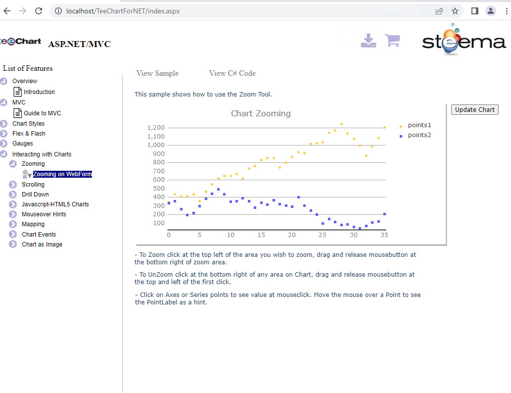

4. The app now runs in IIS without the watermark:
Screenshot from 2022-05-30 14-50-11.png (81.74 KiB) Viewed 8037 times
