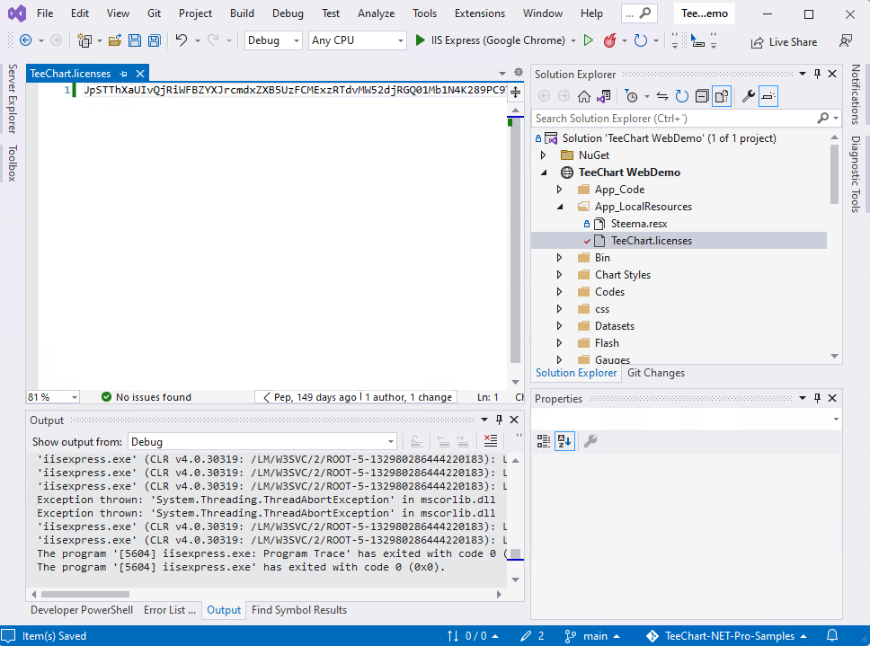

I think there's an example of an old project type in our GitHub sample repos, specifically this sample here. I've just updated this sample to version 4.2022.4.26, and using this version I can paste in my license information to the empty TeeChart.licenses file as shown here:

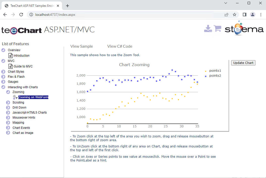

When I run this project the evaluation watermark is no longer shown:
