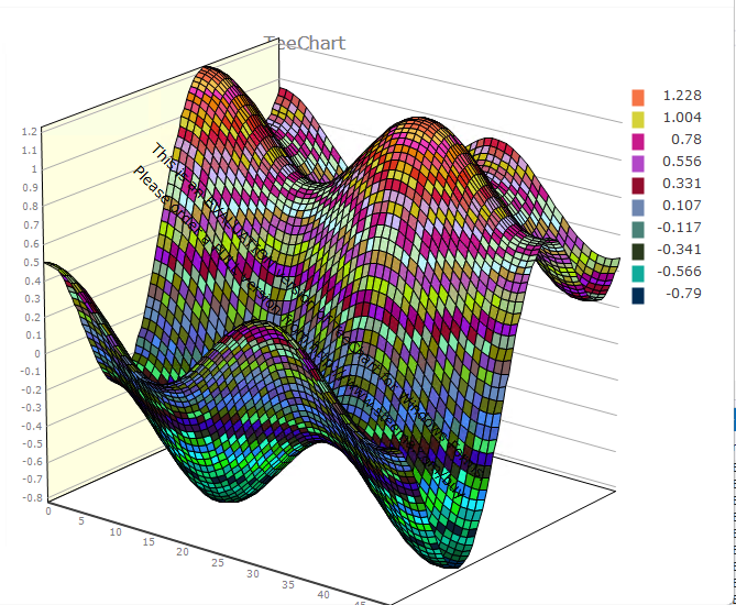

Post by Christopher » Fri Jul 01, 2022 11:34 am
Hello Holgar,
we're looking at this now, and we've got a quick question to ask you if that's okay with you. When you say that:
hkoesa wrote:
Wed May 25, 2022 4:51 am
The AddPalette function is similar to what I like to have but it does not automatically scale with Z values.
what code can we use to see what you mean? The following code generates a palette with 64 unique colours, but we can't see how the palette fails to scale with Z values. Please note that palette colours depend on Y values, not Z values, and each time we add a new colour to the palette we define the Y value up to which we want to paint in that colour:
      double GetYValue(double x, double z, int iNumXValues, int iNumZValues)
        return 0.5 * Math.Pow(Math.Cos(x / (iNumXValues * 0.2)), 2) +
          Math.Pow(Math.Cos(z / (iNumZValues * 0.2)), 2) -
          Math.Cos(z / (iNumZValues * 0.5));
      tChart1.Aspect.View3D = true;
      tChart1.Aspect.Chart3DPercent = 80;
      tChart1.Aspect.Zoom = 80;
      tChart1.Zoom.Direction = Steema.TeeChart.ZoomDirections.None;
      tChart1.Tools.Add(typeof(Rotate));
      var surface = new Surface(tChart1.Chart);
      var numX = 50;
      var numZ = 100;
      for (int x = 0; x < numX; x++)
        for (int z = 0; z < numZ; z++)
          var y = GetYValue(x, z, numX, numZ);
          surface.Add(x, y, z);
      var rnd = new Random();
      var rangeY = surface.YValues.Range;
      var numSteps = 64;
      double value = surface.YValues.Minimum;
      surface.UseColorRange = false;
      surface.UsePalette = true;
      surface.ClearPalette();
      var colors = new List<Color>();
      while(colors.Count < numSteps)
        var color = Color.FromArgb(rnd.Next(0, 255), rnd.Next(0, 255), rnd.Next(0, 255));
        if (!colors.Contains(color))
          colors.Add(color);
      colors = colors.OrderBy(x => x.R).ToList();
      for (int i = 0; i < numSteps; i++)
        var step = rangeY / numSteps;
        value += step;
        surface.AddPalette(value, colors[i]);
