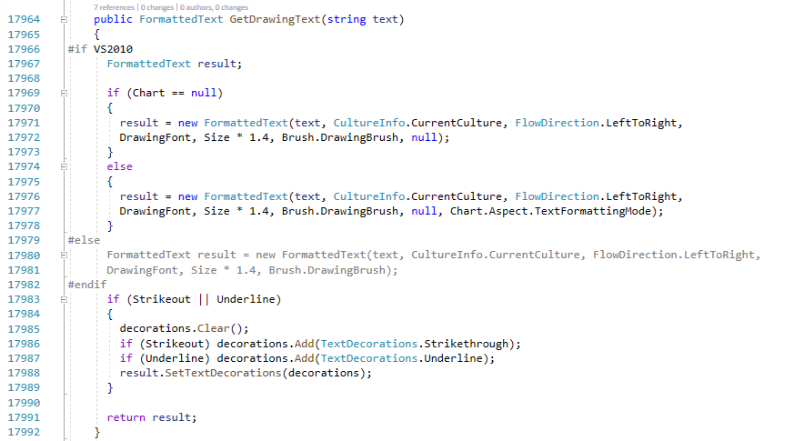

The Font.Size property does. The last TeeChart method called in the stack trace is GetDrawingText, which looks like this: If the Size is zero it will produce the error, but we do not set Size to zero anywhere in the TeeChart.WPF source code. One way to workaround this issue would be to check for zero every time this method is called, but this doesn't really get to the bottom of the issue, which is what is setting Size to zero in the first place. We would be interested in understanding the issue here, and if you're willing we could offer you temporary access to the TeeChart source-code so you could see for yourselves where this zero assignment is being made.

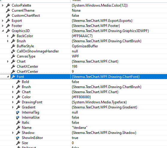

Ok, got some further details:
it appears that the font that has a value of font of the Graphjics3D font is zero.
What affects this value, and how can i change its value?
- Capture.PNG (27.02 KiB) Viewed 13131 times

That Size is the Size I was referring to in my last message. What is of interest, to us, is understanding how this Size comes to be zero, especially given that in previous versions of TeeChart it did not happen (all client code being equal).
There is no universal way to change this value. The Graphics3DWPF is a 'painter', and paints all objects passed to it, many of which have Font properties of their own. So, for example, the Header class has a Font property, and when instantiated and the Chart is rendered, this Font property is assigned to the Graphics3DWPF.Font and the object is rendered. This means that client code may inadvertently be setting an Chart object's Font.Size to zero (e.g. that of the Header, the Axes, the Legend, etc. etc.) and it is this zero-sized Font.Size which is then assigned to Graphics3DWPF.Font which then causes the error when rendered.
