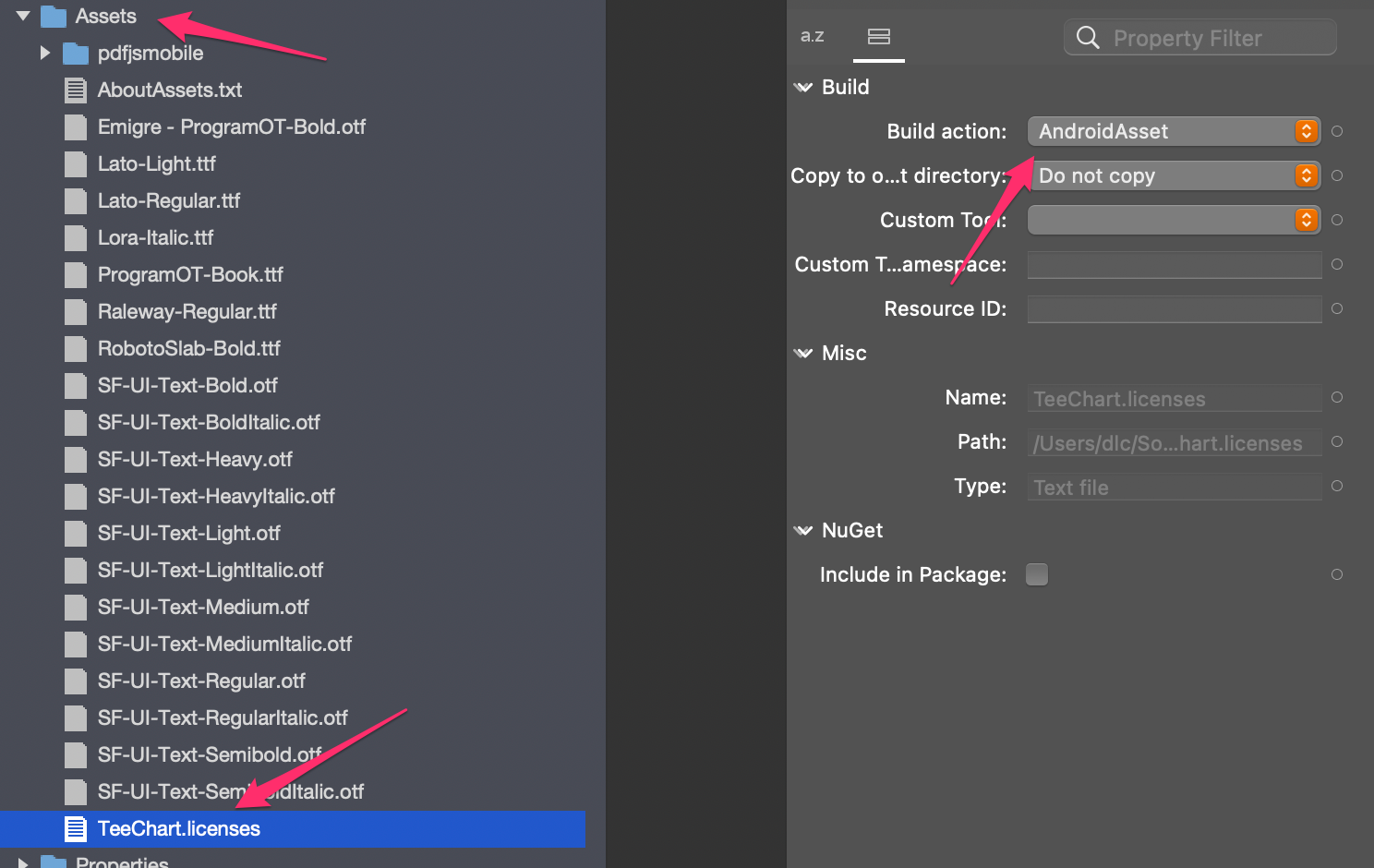

We are developing a Xamarin.Forms app on MacOS Monterey 12.3.1 (21E258). We are using the Steema Chart since a long time and never had troubles with it. We now encounter a problem with the licensing in the Android application.
Whatever we try, we can not remove the watermark in the release build. :(
We created the TeeChart.licenses file on a Windows 10 (10.0.19043.1645) and included it in de project as mentioned in the help (see attachment). This has always worked perfect for years, but since recently we run into this problem.
We are using this version of the nuget package Steema.TeeChart.NET.Xamarin.Forms => 4.2022.2.28
I hope someone has a solution for this, because we really need to push a new version of our apps.

We are checking this. Could you confirm please, that the issue only appeared with 4.2022.2.28 and the previous build number that you used that didn't display the problem if that is the case.
With thanks.

A couple of weeks ago we released a version of our app with version 4.2021.10.20 of the package and then everything was ok. No watermark. When I deploy the same code again to my device I see the watermark.
The problem is not the package.

ok. I've just tried with a license file and a new project that uses the 4.2022.2.28 version and it works fine here.
Could you please send me the license file that you're using directly to my email pep@steema.com so I can check the problem here?

I have sent you the information.
