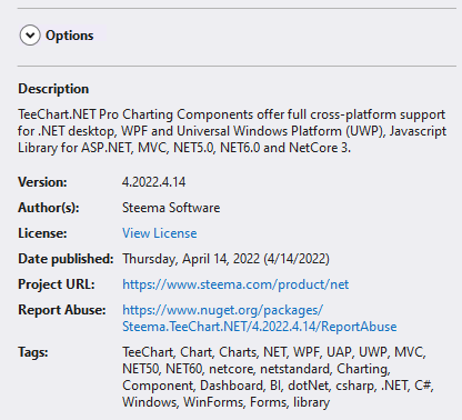

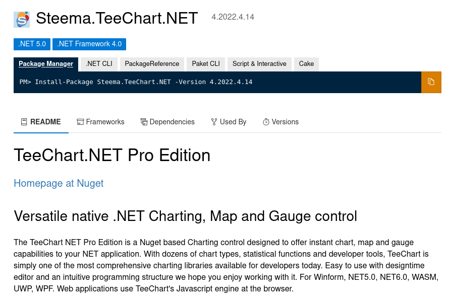

During my tests, another question came up, nevertheless:
When I look at the package in NuGet package manager, the description says: "TeeChart.NET Pro Charting Components offer full cross-platform support for .NET desktop, WPF and Universal Windows Platform (UWP), Javascript Library for ASP.NET, MVC, NET5.0, NET6.0 and NetCore 3."
Besides NET5.0 I also tried NetCore 3.1, but that doesn't work. I get a NuGet warning NU1701
Package "Steema.TeeChart.NET 4.2022.4.14" was restored using ".NETFramework,Version=v4.6.1, .NETFramework,Version=v4.6.2, .NETFramework,Version=v4.7, .NETFramework,Version=v4.7.1, .NETFramework,Version=v4.7.2, .NETFramework,Version=v4.8" instead the project target framework ".NETCoreApp,Version=v3.1". This package may not be fully compatible with your project.
and the program does not compile (or it crashes at runtime). Do you still support .NET Core 3.1?
We don't distribute assemblies for .NET Core 3.1, but we can certainly build some for you if you need them.
There is a mismatch though between what the NuGet package reports in Visual Studio:

And what our NuGet webpage reports:
Screenshot from 2022-04-20 16-06-45.png (101.83 KiB) Viewed 12032 times
Thank you for pointing this out to us, we'll update them both as soon as possible.
