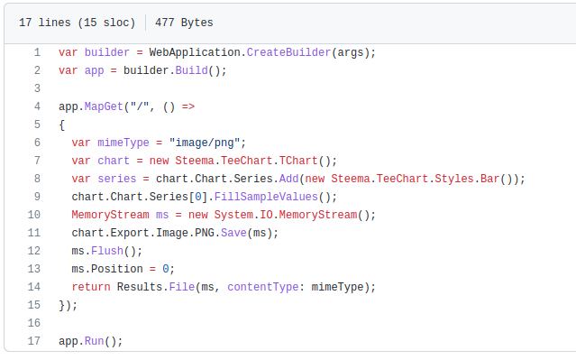

You're very welcome. I've created a new .NET 6.0 ASP.NET Core project from the empty template and have left it here:
https://github.com/Steema/TeeChart-NET- ... SPNETEmpty
The code is very similar to yours:

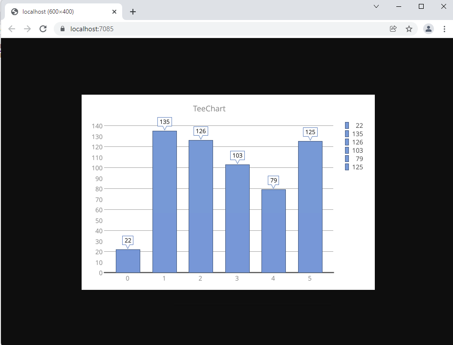

And when the TeeChart.licenses file has valid content, it gives me:

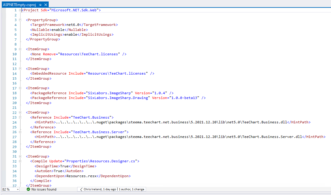

there is a problem with the licensing code in TeeChart.Business.Server.dll for .NET 6.0 - please accept our apologies for the error. However, not all is lost - you can still use TeeChart.Business.Server.dll for .NET 5.0 in the example .NET 6.0 ASPNETEmpty project, and your license will work.

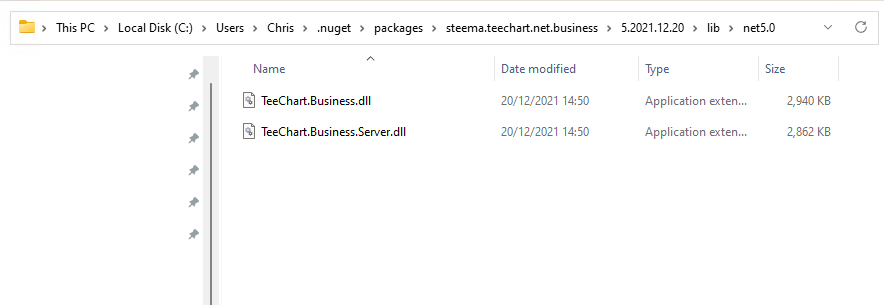

To do this, please reference the assemblies directly from the NuGet package on your hard disk, which is usually located under your User - in my case it is:
C:\Users\Chris\.nuget\packages\steema.teechart.net.business\5.2021.12.20\lib\net5.0
Screenshot from 2022-01-07 17-21-25.png (17.04 KiB) Viewed 18115 times

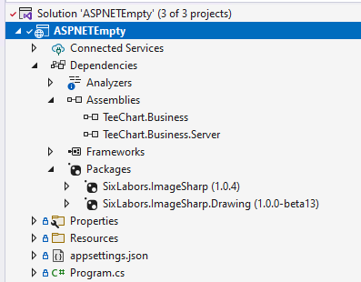

Add these two assemblies as COM references to the project - you will also need to manually install two NuGet dependencies (one of which is a beta version), namely: Which will give you:
Screenshot from 2022-01-07 17-16-18.png (16.84 KiB) Viewed 18115 times
