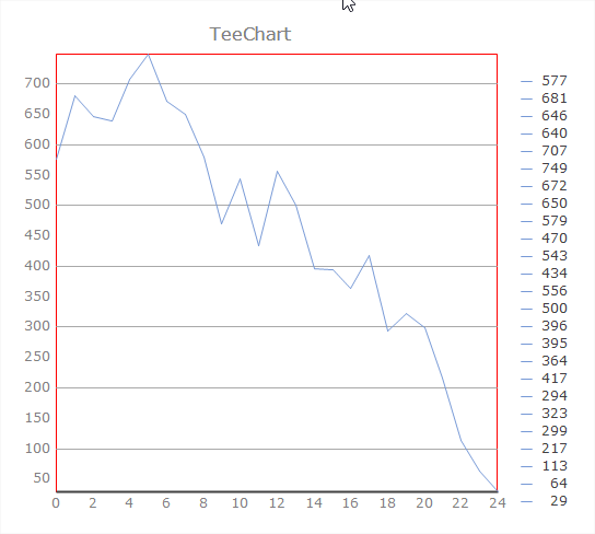

After version updating TeeChart 4.1.2012.1032 ==> 4.2018.11.27
The top outer border does not appear.
Can you guess what the problem is?

goodsj wrote:
Thu May 23, 2019 4:17 am
Do you have the Back Wall set to visible? Using the following code works as expected here:
            InitializeChart();
            tChart1.Walls.Back.Visible = true;
            tChart1.Walls.Back.Pen.Color = Color.Red;

Hello.
I tried following the attached code above , but it doesn't work. :|
There is no change..
Do you have any other ideas?
