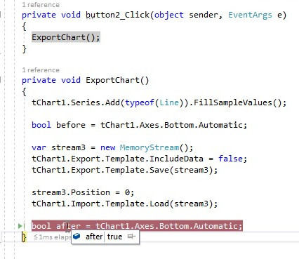

I'm trying to save the config of 3 charts in the registry when the application closes. i have an issue that amongst other things [ but an obvious one ] if I have set the bottom axis to be auto scaled, you can see it is set to auto if you inspect it, then export a stream, rewind the stream and re-import it to the same chart, the axis is no longer auto
if I do the following:
frm.tcAmGraph.Axes.Bottom.Automatic
[true]
var stream3 = new MemoryStream();
frm.tcAmGraph.Export.Template.IncludeData = false;
frm.tcAmGraph.Export.Template.Save(stream3);
stream3.Position = 0;
frm.tcAmGraph.Import.Template.Load(stream3);
[false]
what am i missing?
thanks
Andy

Hello Andy,
using the latest publicly available version of TeeChart.dll (4.1.2018.05040) I cannot reproduce this issue:

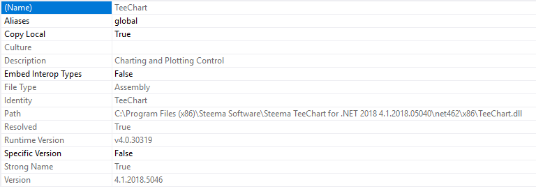

which version of TeeChart.dll are you using?

Post by AndyRea » Mon Oct 01, 2018 10:57 am
v4.0.30319
will get the latest and try again

I was wrong it was the latest
i'm more puzzled now

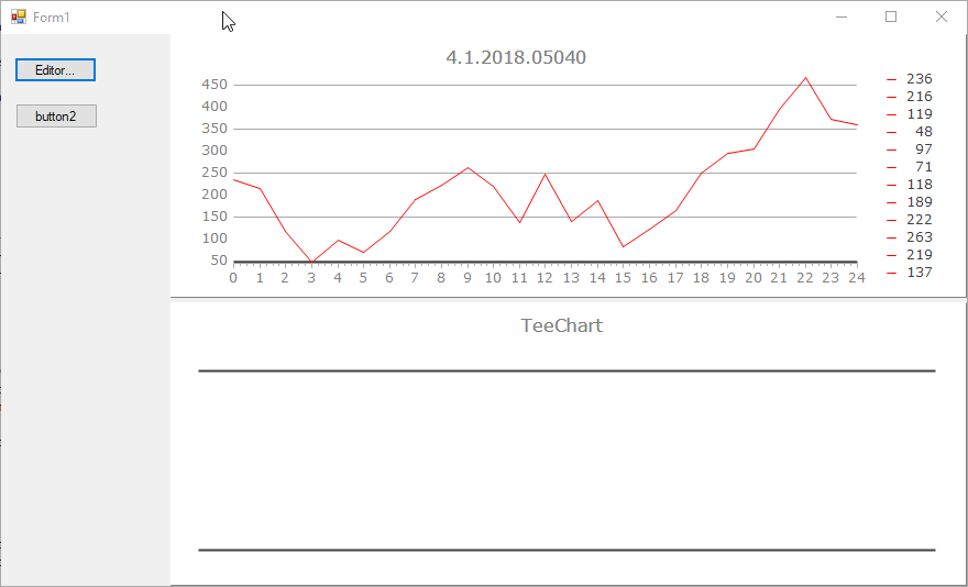

using the following code:
			CreateCharts();
			InitializeChart();
		private TChart tChart1, tChart2;
			FastLine fastLine = new FastLine(tChart1.Chart);
			fastLine.FillSampleValues();
			fastLine.Color = Color.Red;
			MemoryStream stream = new MemoryStream();
			tChart1.Export.Template.Save(stream);
			stream.Position = 0;
			tChart2.Import.Template.Load(stream);
		private void CreateCharts()
			tChart1 = new TChart();
			tChart2 = new TChart();
			tChart2.Dock = DockStyle.Fill;
			tChart1.Header.Text = Utils.Version;
			splitContainer2.Panel1.Controls.Add(tChart1);
			splitContainer2.Panel2.Controls.Add(tChart2);
I obtain the following result:
here the FastLine series color does not seem to be affected by template exportation and importation.
