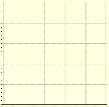

Hello Steema,
We were using the Teechart version 4.1.2010.9282 initially.
But we faced an issue related to out of memory exception as discussed http://www.teechart.net/support/viewtop ... =4&t=16731
So based on the suggestion from above post, we upgraded the Teechart to version 4.1.2017.10191

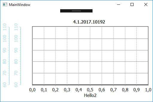

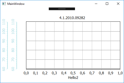

After using the recent updated Teechart assembly, one of our client is complaining that the default look of the component has been changed.
Please see the attachments where 1.jpg is the appearance with Older version and 2.jpg is the appearance with the latest version.
Ex: You can notice that the top and right borders are missing with latest versions of the Teechart assembly.
Please assist us in this regard that why did the appearance got changed after upgrading the latest assembly and how to overcome it.
It is critical for our clients to retain the same look and feel without any degrade in the functionality.
Best Regards
Best Regards
- New Version
- 2.jpg (21.7 KiB) Viewed 28261 times
- Old Version
- 1.jpg (27.47 KiB) Viewed 28262 times

Hi Christopher,
We have a tool to see the graph component as depicted in the previous images.
So if I change my tools reference to the older version of Teechart assembly and recompile my tool, it shows me the correct Graph(as depicted in 1.jpg).
If I change the reference to latest version of Teechart assembly and recompile my tool, it shows me the Graph as depicted in 2.jpg.
This is the only evidence I got. No source code change in my tool and just the reference change of Teechart assembly changes the appearance of graph.
If required, I can demo it in a remote session on a mutually agreed time.
Creating a sample app to demonstrate the issue isn't feasible.
Can you suggest me the relevant property to bring back the original look?

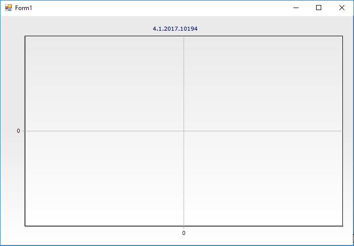

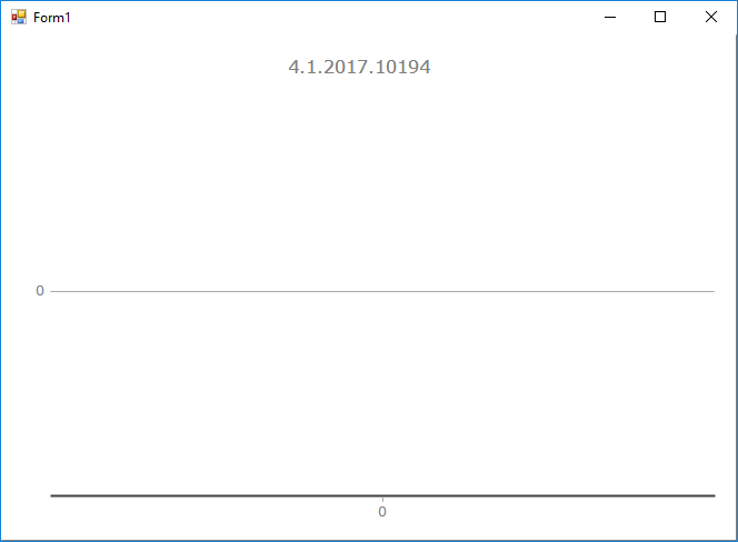

When I run the following code using the TeeChart version you are using:YTI wrote: Creating a sample app to demonstrate the issue isn't feasible.
TChart chart = new TChart();
chart.Dock = DockStyle.Fill;
chart.Header.Text = Utils.Version;
Line series = new Line(chart.Chart);
this.Controls.Add(chart);
This is what the default chart looks like with a series with no values in it. This default chart is different to the default chart you show me in your images, and it is different because you are coding the chart to make it look different. Could you please give me the code you are using to make your chart look the way it does? Without being able to reproduce your default chart here I'm afraid we won't be able to help you.

Further to this - to bring this default look to previous versions of several years ago, you can use a single line:Christopher wrote:Could you please give me the code you are using to make your chart look the way it does? Without being able to reproduce your default chart here I'm afraid we won't be able to help you.
chart.CurrentTheme = ThemeType.Opera;

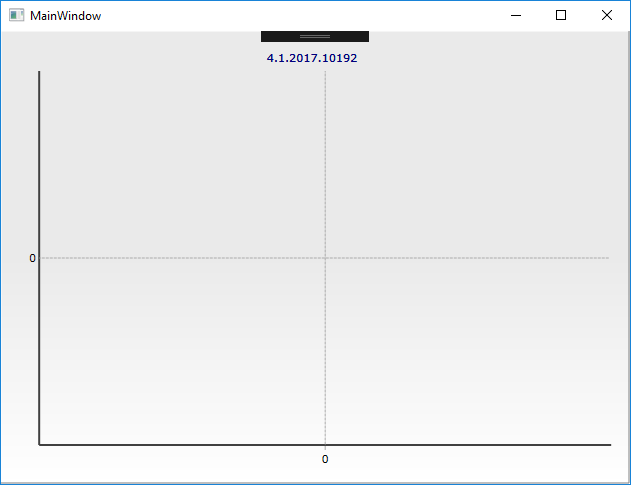

The code I posted is for TeeChart.dll, the Windows Forms version of TeeChart. Using the TeeChart.WPF.dll, the WPF version of TeeChart, the following code is required:
which gives:
public MainWindow()
chart.Margin = new Thickness(0);
Steema.TeeChart.WPF.Styles.Line series = new Steema.TeeChart.WPF.Styles.Line(chart.Chart);
this.grid1.Children.Add(chart);

Hi Christopher,
Thank you for providing code related to Teechart.WPF.dll.
How to get the rectangular border using the latest assembly as you displayed in TeeChartPro_2018-05-09_14-12-13.png ?

Yes, there are two lines you can add to obtain this border, i.e.YTI wrote: Thank you for providing code related to Teechart.WPF.dll.
public MainWindow()
chart.Walls.Back.Visible = true;
chart.Walls.Back.Pen.Visible = true;
No clues from the stack trace I'm afraid - could you please send me some code with which I can reproduce the problem here?YTI wrote: Also when I apply the theme in a sample app, it does not throw any exception.

Hi Christopher,
Thanks for sharing two new properties related to Border.
Were these properties enabled by default previously and turned off in later versions?
Please find a sample project to note the difference between the old and new assembly of TeeChart.WPF.dll.
Kindly add the reference of the versions as I mentioned earlier and see the notable differences.

Okay, I think we have a solution. Using the following code in the two versions I obtain:
TChart tChart1 = new TChart(false); //<- set false in the constructor for latest version
public MainWindow()
string Version()
string version = typeof(Chart).Assembly.GetName().Version.ToString();
if (version.Length == 13)
version = version.Insert(9, "0");
return version;
tChart1.Panel.MarginLeft = 1;
tChart1.Panel.MarginRight = 1;
tChart1.Panel.MarginTop = 10;
tChart1.ClipToBounds = true;
tChart1.Aspect.ClipPoints = true;
UpdateTeechartBasicSettings();
UpdateTeeChartDisplaySetting();
FillTeeChartSeriesDataDesignTime();
tChart1.Header.Text = Version();
this.grid1.Children.Add(tChart1);

There is no equivalent property, this flag only exists in the constructor. However, given that you will have made no changes to the Chart at designtime in XAML you will lose no information whatsoever by instantiating the Chart at runtime.YTI wrote: In the sample app, we created the Teechart module in code behind. However in our actual application, the teechart component is created in XAML file, so no code behind initialization. In this case, how to setup the 'setTheme' flag? Suggest me the equivalent property name please.
Without being able to reproduce the problem here I'm afraid I have no idea for a fix to it.YTI wrote: Also in my previous image 2.jpg(New version) you can see that the vertical lines aren't aligned properly. I am not able to replicate that behavior with my sample application. Any idea about the fix for that issue ?
It is so you can see that I am using the relevant version of the TeeChart.WPF.dll in my screenshots.YTI wrote: Also what is the significance of the 'string Version()' method within mainWindow method in your last provided code snapshot?
No, this will not be possible.YTI wrote: We are able to identify 2 downgrades from old version to new till now, but not sure how many are hidden yet.
