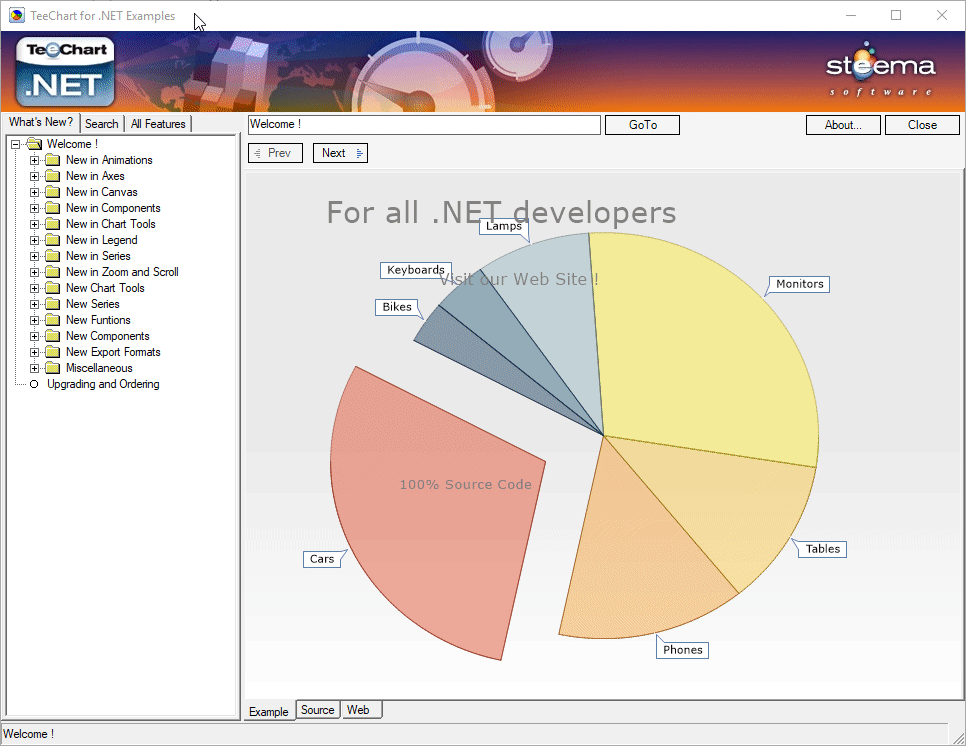

Yes, there's a good example of how to do this in the Feature Demo shipped with TeeChart:
