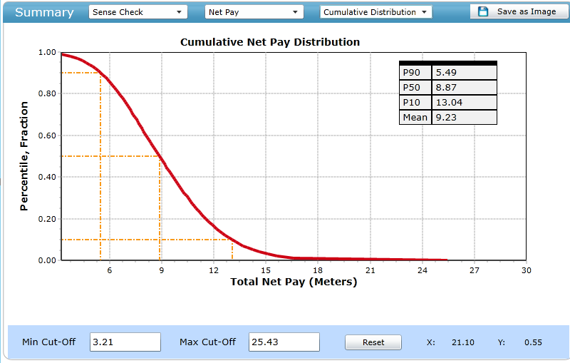

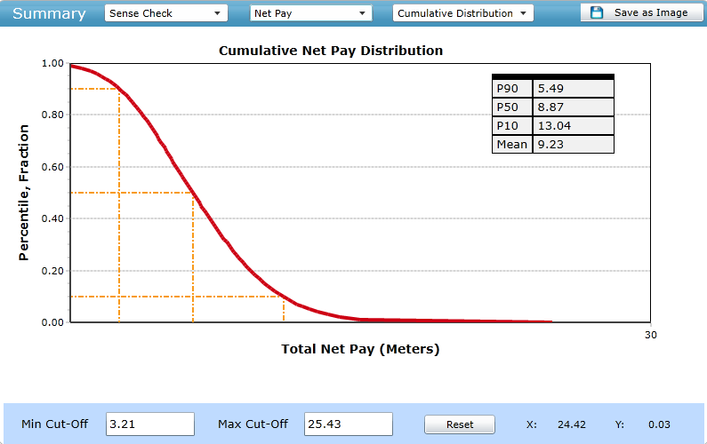

We are facing some time grid line missing issue for bottom axis. We are using t chart in silverlight application.
please see below image. Without bottom axis grid lines.
Now i am showing this image with grid lines.
This issue is coming with us please provide some solution. we are doing chart refresh but it is happening.

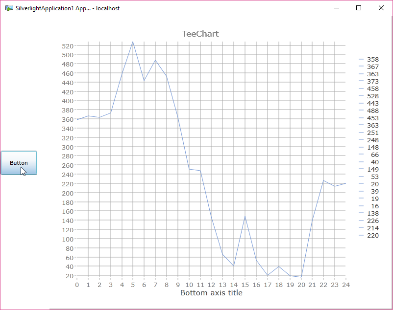

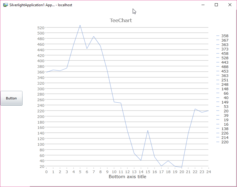

I'm having a little difficulty reproducing this one here - if I use the following code in a Silverlight project:
		public MainPage()
			InitializeChart();
			tChart1.Series.Add(typeof(Steema.TeeChart.Silverlight.Styles.Line)).FillSampleValues();
			tChart1.Axes.Bottom.Title.Text = "Bottom axis title";
		private void button_Click(object sender, RoutedEventArgs e)
			tChart1.Axes.Bottom.Grid.Visible = !tChart1.Axes.Bottom.Grid.Visible;
This gives me the following:
and
would you please be so kind as to retouch the above example so I can reproduce your issue here?
