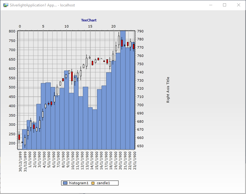

please find attached a screen image of the situation I'm currently experiencing. My development environment is Windows 7, Silverlight 4.0 and VS 2012.
I would like to have the legend moved lower not to overlap the datetime x-axis label values.
I would also like to have the right axis title moved up (centered) and a bit to the right.
Text alignment, Legend alignment and label alignment doesn't help much.

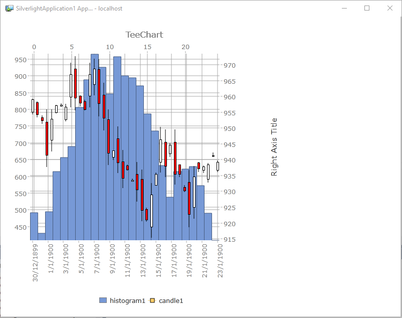

Re: TeeChart.Silverlight: Legend & Axis Label Placement
Running the following code using the latest version of TeeChart.Silverlight.dll:
gives me the following output:
do you get the same result using this code?
public MainPage()
TChart tChart1 = new TChart();
tChart1.Margin = new Thickness(0);
LayoutRoot.Children.Add(tChart1);
tChart1.Series.Add(typeof(Histogram)).FillSampleValues();
tChart1.Series.Add(typeof(Candle)).FillSampleValues();
tChart1[1].VertAxis = VerticalAxis.Right;
tChart1[0].HorizAxis = HorizontalAxis.Top;
tChart1.Legend.Alignment = LegendAlignments.Bottom;
tChart1.Axes.Right.Title.Text = "Right Axis Title";
tChart1.Axes.Right.Title.Angle = 90;
tChart1.Axes.Right.Labels.CustomSize = 100;
tChart1.Panel.MarginRight = 30;
Thank you Christopher,
The combination of the Angle and Custom Size did the trick for the right-side y-axis title. The bottom legend overlapping is still overlapping.

- Guru
- Posts: 1603
Using the TeeChart.Silverlight.dll under:
Steema Software\Steema TeeChart for .NET 2016 4.1.2016.10260\net35\x86\TeeChart.Silverlight.dll
I obtain a similar result using the previous code:
