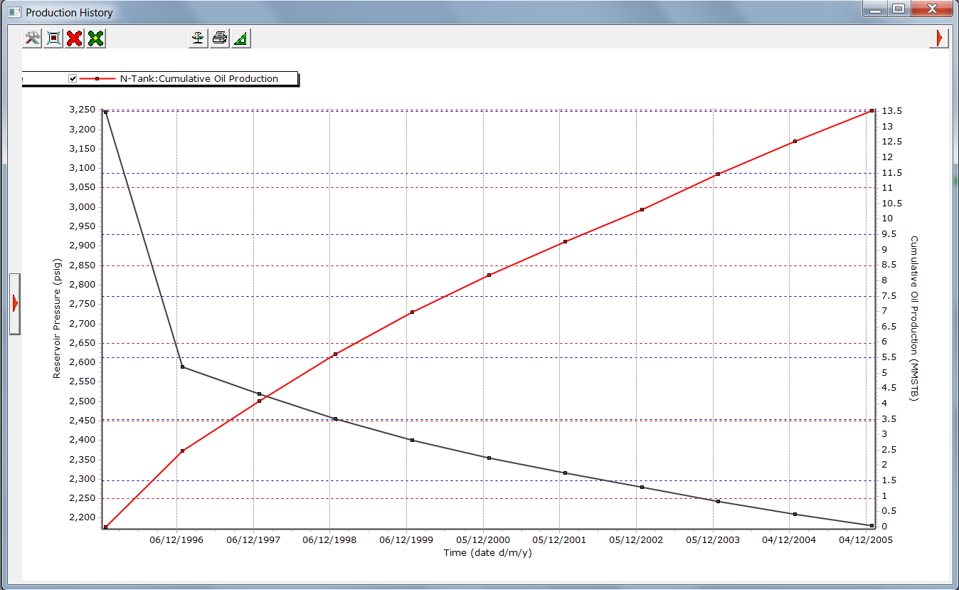

In the past we have been setting the legend alignment on our plots to the right of the plot i.e. Legend.Alignment = 1
This worked OK
We recently tried setting the Alignment to the top of the plot i.e. Legend.Alignment = 2
Although the legend does appear at the top of the plot it appears far over to the left so only the right hand part of the legend is visible (the left hand part of the legend is off the plot area).
If I move the mouse over the plot area it will eventually re-center itself correctly on the plot.
I also tried looking at the plot properties dialog and the Legend-Position tab showed no position selected.
Is there another property we need to set to center the legend?
This worked OK

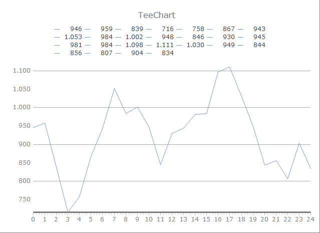

Using the latest public release of TeeChart, the following code:
gives me the following:
Which version of TeeChart are you using? Can you give me a simple code example which reproduces your problem?

The version of TeeChart.dll is 4.1.2011.4193.
We use a wrapper but we end up calling the following:-
x_chart.Legend.Visible = true;
x_chart.Legend.LegendStyle = Steema.TeeChart.LegendStyles.Series;
x_chart.Legend.CheckBoxes = true;
x_chart.Legend.Alignment = Steema.TeeChart.LegendAlignments.Top;
When the plot is first created we get the plot shown in the attachment with the legend too far over to the left.
If you resive the plot or move the mouse over the data then the legend suddenly moves into the center.
Thanks for any assistance.

The oldest version I presently have installed on my machine is 4.1.2013.5280 - running the following code:
gives me:
Would you please be so kind as to run this code in a new WinForm project with just a TChart on the form?
