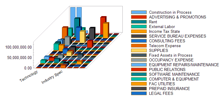

As an example this might be a chart where the user can see all of the bars:
Original everything okay.PNG (32.9 KiB) Viewed 9436 times

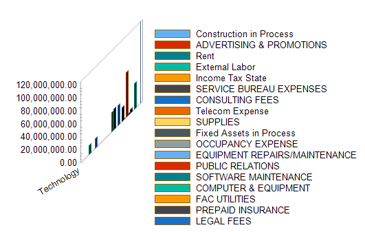

But the user resizes the chart until the chart cannot be displayed:
resize until no thickness.PNG (21.69 KiB) Viewed 9435 times

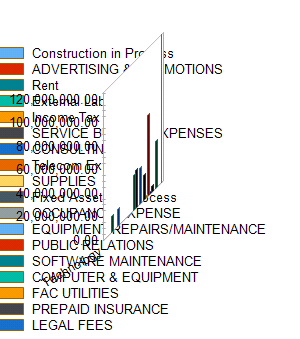

Or even worse until things start overlapping:
Way too small.PNG (19.76 KiB) Viewed 9431 times
So is there any way to know if the chart and legend are overlapping or if the chart cannot be drawn any smaller?
