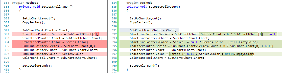

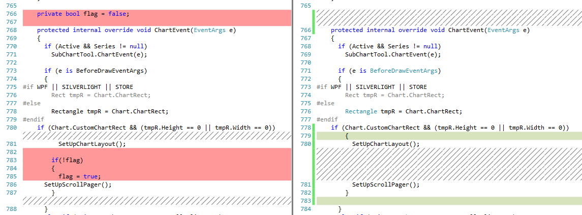

If you have the source code, within the ScrollPager.cs unit you can make these changes:
these should fix the designtime issues for you.

That has resolved the exception, but after the change in code the subchart is not scrollable at all. I can not change the selection/ boundary for the scrollable chart in design mode.
