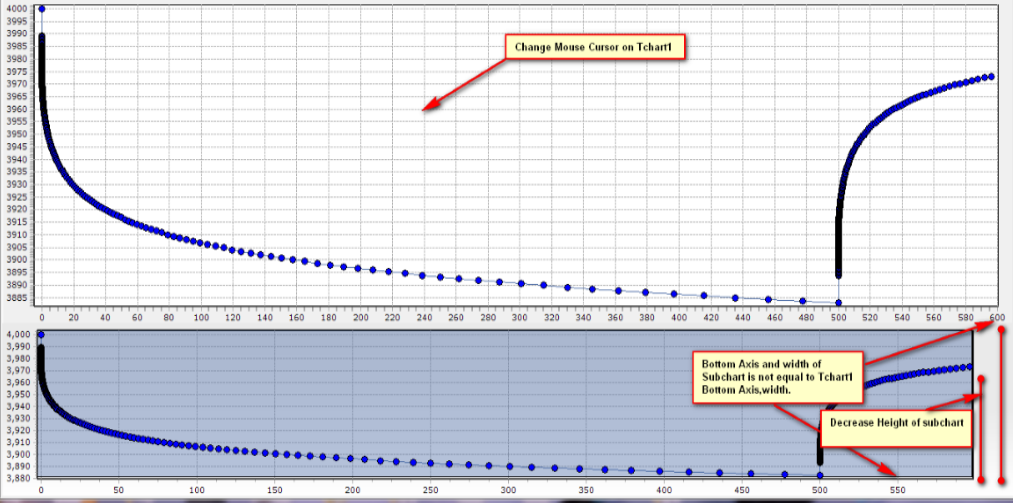

1- When first time chart opens, Bottom axis of subchart is not shown. So how it will display?
Image 1

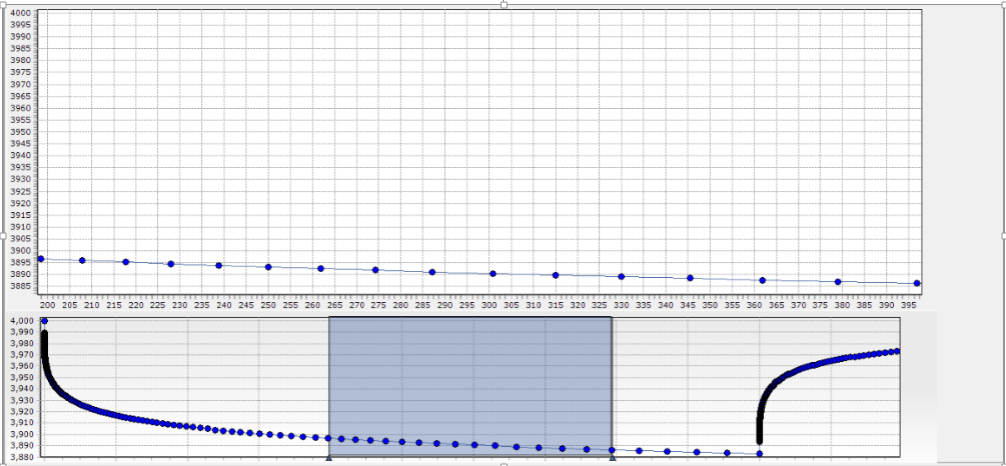

2- How to set Bottom Axis and width of subchart.
image 2
3- How decrease the height of Subchart.
4- How to Change the mouse Cursor on Tchart.
5- How to Know on Which Chart (Tchart,Subchart) mouse Cursor is Present.
6- Add or Delete some points of Line from Tchart. Then how subchart points will be updated.
7- How to know on which Tchart or Subchart Mouse Click is performed.

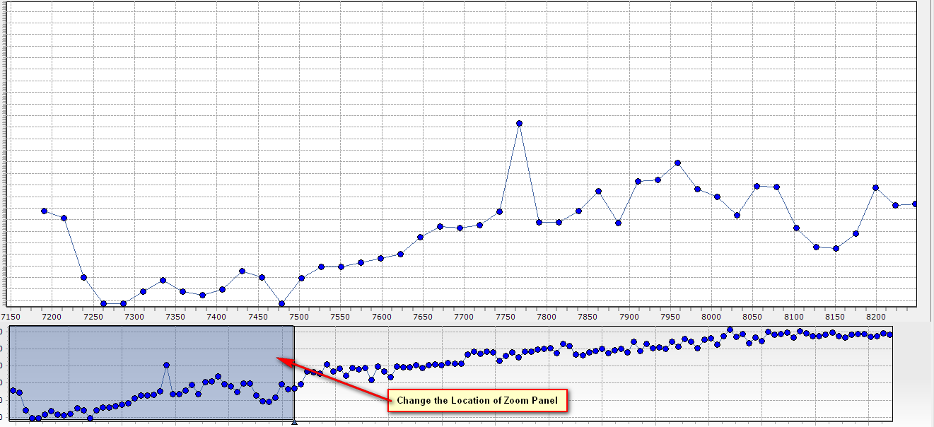

1. Add or Delete Points From Tchart. The Location of Zoom Panel of Subchart is Changed ( to Default Location). But we want to preserve/set the last Zoom Panel location of Subchart.

amol wrote: 1. Add or Delete Points From Tchart. The Location of Zoom Panel of Subchart is Changed ( to Default Location). But we want to preserve/set the last Zoom Panel location of Subchart.
That's a consequence of bug #1281. You need to save ColorBand's start and end values and set them after deleting points:
        double start = scrollPager1.ColorBandTool.Start;
        double end = scrollPager1.ColorBandTool.End;
        scrollPager1.SubChartTChart.Series.Clear();
        tChart1[0].Delete(0, 100);
        scrollPager1.Series = tChart1[0];
        scrollPager1.ColorBandTool.Start = start;
        scrollPager1.ColorBandTool.End = end;

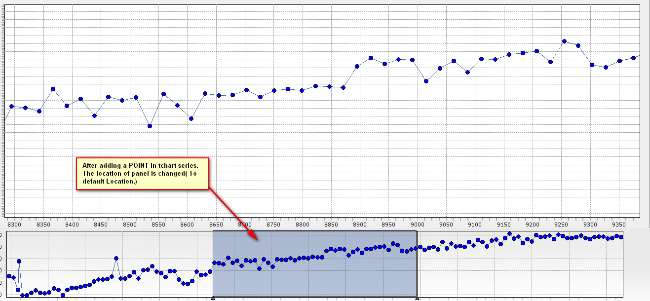

1. In Sub chart , Move the Zoom Panel.
Image 1
2. Add a point in the Series of Tchart. The Location of Zoom panel is automatically change ( to Default Location).
Image 2

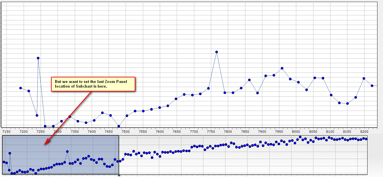

But we want to preserve/set the last Zoom Panel location of Subchart is here.
Image 3
3. After Add point in line series of Tchart, Update subchart series and panel location is given as below,
double start =ScrollPagertool.ColorBandTool.Start;
double end = ScrollPagertool.ColorBandTool.End;
ScrollPagertool.SubChartTChart.Series.Clear();
ScrollPagertool.Series = line;
ScrollPagertool.ColorBandTool.Start = start;
ScrollPagertool.ColorBandTool.End = end;
But it does not giving desired result.

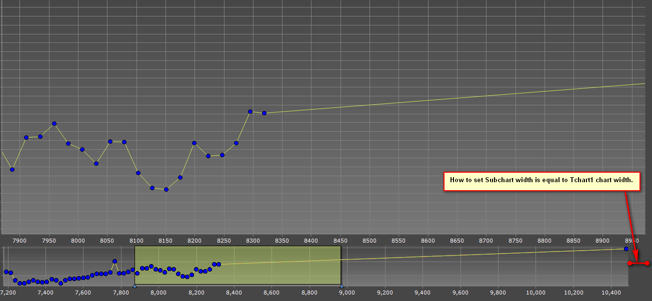

1. How to set subchart width is equal to tchart1 chart width.
Fig1

amol wrote:1. How to set subchart width is equal to tchart1 chart width.
Could you please post a simple example project with which we can reproduce your problem here?
