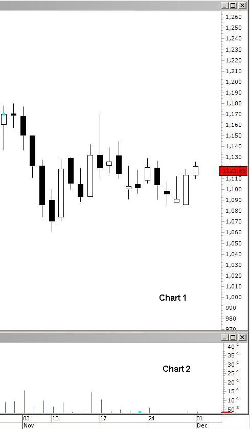

As shown in the above image, we need to align Right Axes of Multiple Charts? We did extensive R&D on this. When the Value Labels (Right Axis Value Label) of Both Charts are same, both charts automatically aligns there Right Axes respectively; but when the value labels of both charts are different it gives us problem as shown in image. Please share us sample code for the same.

Hi Quant,
You could try doing something similar to what Yeray suggested here.

Thank you very much. It solves the problem.
