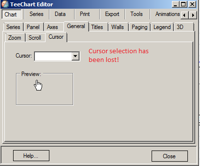

When opening up the designer for the teechart, I now discovered that for some reason the cursor selection has been lost on the whole teechart (see attached image).

I'm afraid that the fix to defect id=1020 has broken this functionality. Many apologies for any inconvenience this has caused. I have added this defect to our database with id=1115 and have already fixed it.
In the meantime, as a partial workaround (changes made in the Chart Editor will not be reflected), you can use this code:
