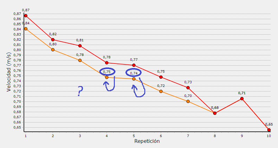

Hello folks,
This may be an idiot question but I cannot find how to place marks/labels below (instead of above) the symbols in a Line graph. Where is the property to do this?
Thanks!
Luis Sánchez
Re: How to place marks below symbols?
Post by Narcís » Tue Dec 30, 2014 9:55 am
Hello Luis,
There are two options here:
1. Setting a negative value for Marks.ArrowLength, for example:
      line1.Marks.ArrowLength = -20;
2. Using custom marks position as shown here.
ERGOTECH
Posts: 2
Joined: Wed Mar 12, 2014 12:00 am
Post by ERGOTECH » Tue Dec 30, 2014 10:07 am
Thank you very much, Narcís!
First solution is simple and works fine for my purposes :)
