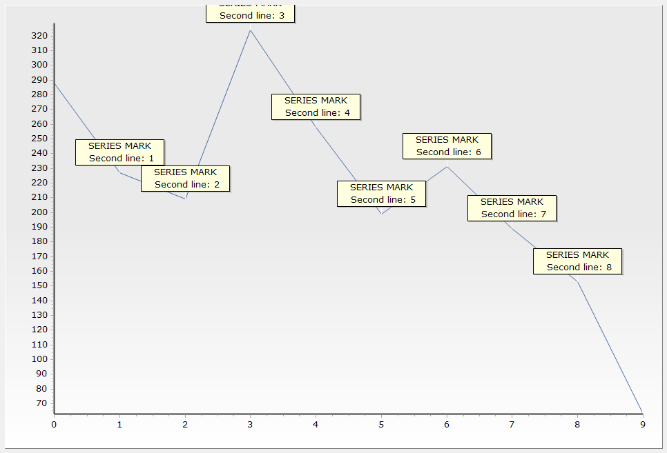

I have an issue when I add more than one line of text to the series marks.
As you can see in the screenshot, part of the series mark is cut off.
The code I wrote to get this chart is the following:

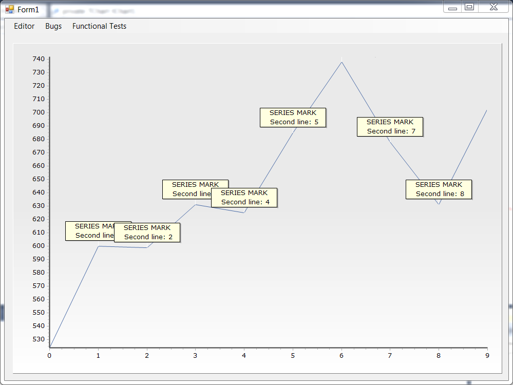

If I set the Clip property to false, I don't see a label at all for my highest point, as you can see in the screenshot at point number 6.
I want to make sure that my labels are visible all the time.
If you change the chart to 3D, the label is visible. It is shown a little bit 'above' the chart, but if you switch to 2D, the label is not shown.
What can I do to have the label shown in all cases.

In your case, my recommendation is that uses Clip Marks property as false and increase the TopMargin, using next lines of code:
Series1.Marks.Clip = false;
            tChart1.Panel.MarginTop = 7;
Could you tell us if previous code help you to solve your problem?
