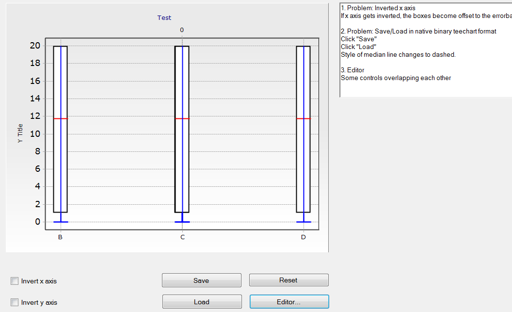

Hi Sandra,
attached a project file demonstrating the problem. I have found other problems, such as changing line style of the Medianline in boxplots after saving/loading from binary format, and inverting the x axis. An old problem still persisting is the overlapping controls of the editor. I remember that on your machine you could reproduce it neither, and I am concern that something on my machines causes some weird behavior. I would appreciate if you can test the attached demo project, and see if you can reproduce similar behavior. I have attached pictures of what I see on my machine.
Thanks Oli
Thanks Oli

Hello Oli,
If you want work with editor, you must change manually the minimum and maximum of axis.
Ok. I can reproduce your problem and I have added it in bug list report[TF02016181]. We will try to fix it for next maintenance releases of TeeChart.Net.1. Problem: Inverted x axis. If x axis gets inverted, the boxes become offset to the errorbars (whiskers).
I have added this problem as a bug in bug list report with number [TF02016183]. We will try to fix it for next maintenance releases of TeeChart.Net.2. Problem: Save/Load in native binary teechart format Click "Save" Click "Load" Style of median line changes to dashed.
This is not a bug. If you assign a series to different axis, for default the scale of axis recalculate the values and set new values to Axis. In your case when you change the Horizaxis of one of your Bloxplot series, the minimum and maxim are 0 or have a different scale of Bottom Axis. For this reason I recommend you set the same scale for top axis and bottom axis as do in next line of code:3. Assigning a Series to top axis
Assign first series to top axis (through editor), and it will
disappear...at least on my machine
boxplot1.HorizAxis = HorizontalAxis.Top;
tChart1.Axes.Bottom.SetMinMax(0, 2);
tChart1.Axes.Top.SetMinMax(0, 2);

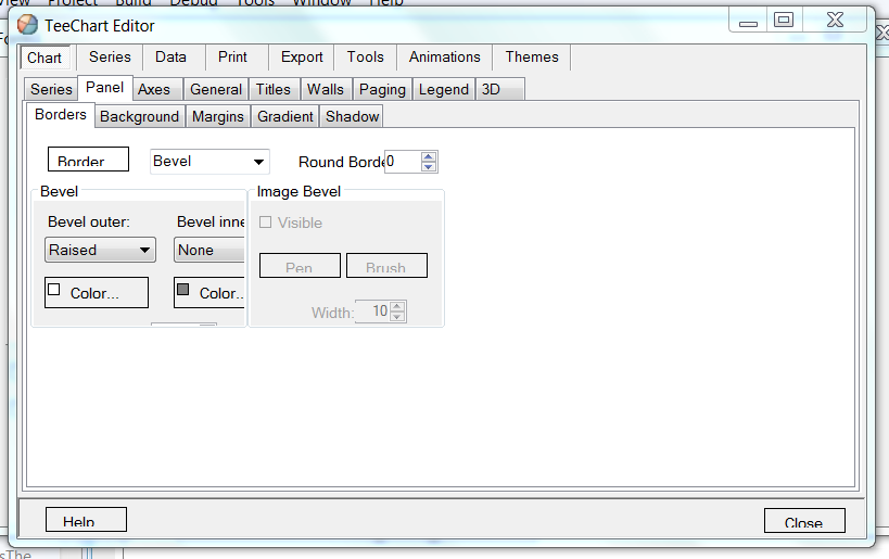

I have attached another screenshot of how the editor is display on my computer. I use the following code :
Dim editor1 As Steema.TeeChart.Editor = New Steema.TeeChart.Editor(tChartBoxPlot)
editor1.Width = Convert.ToInt32(800)
editor1.Height = Convert.ToInt32(500)
editor1.ShowModal()
It could possibly be a computer-specific problem, and I will change to a new computer next month. I keep you updated if this problem persist on the new computer.
Cheers
Oliver

As I said in the thread we cannot reproduce your problem here with our machines and using your code I have gotten next results: When you have made the test with other machine, please tell us the results.

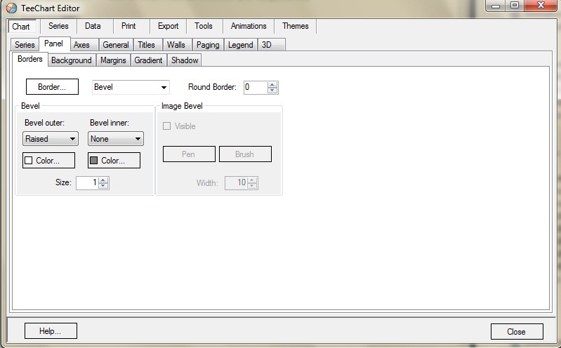

Hi Sandra,
that is an older post regarding the editor. On my new machine the editor looks just fine, so it was a machine-specific problem. However, I could not figure out how to solve it on my old machine. Just for your information.
Oli
Oli
